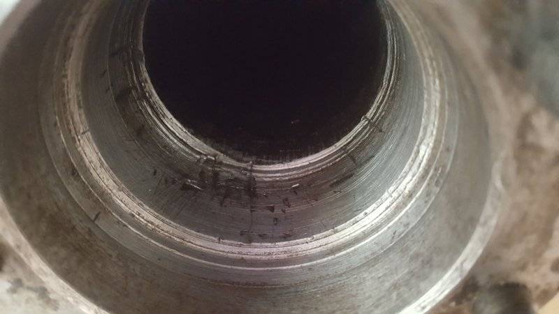

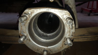

With just an o-ring on the OD of the bearing, I like to use the stock type axle seals.Green bearings require no seal.
Doug
I would think if the housing was bent bad enough to take out the seals, it would also take out other parts.A bent or warped rear end tube will also eat seals and bearings.
