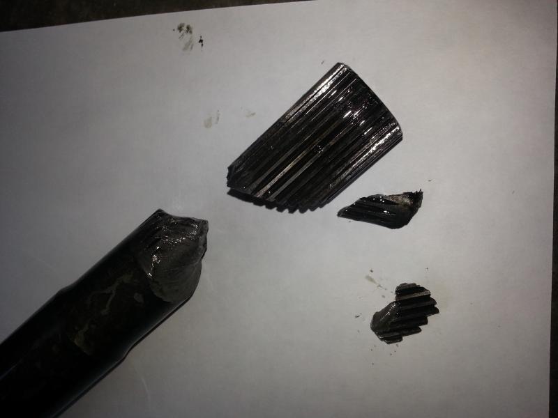

135.jpg I ran stock axles for years and figured I was on borrowed time so I went with Strange SS axles running 11.70s 8 3/4 3.91 with a spool in a 65 post totally shattered the left rear at 50 passes. Since I have 100 on mosers well worth the extra money. Now its the gears Im fighting, the housing is being backbraced as we speak flange to flange
