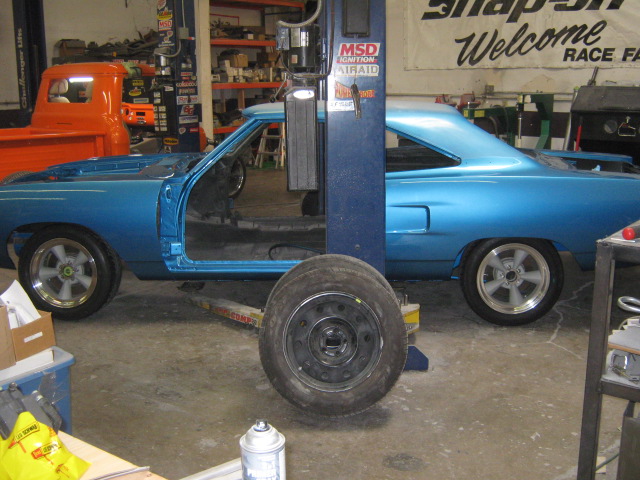

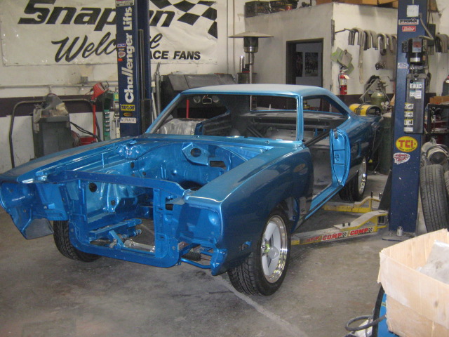

Got the calipers on today to see how close the clearance was to the wheels. I was sweating it because they rubbed the inside of the 17's that I was using during fab work. I have about 1/4" so it is good. The 17's with 225 55 tires look ok too I think. Not too big. I wish there was a bigger selection of 17 tires. The wheels are 8" wide.
Can't wait to get some weight in it to see how it settles. IMG_1322.jpgIMG_1321.jpg

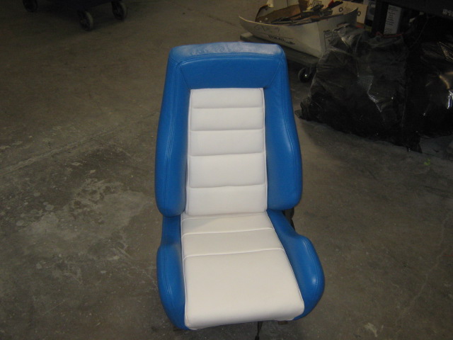

I picked up my driver seat today, I am very happy with the work. The headrest is at the embroidery shop having "GTX" logo sewn in.

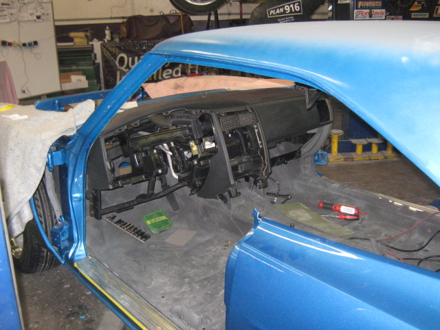

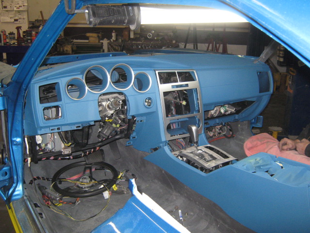

Dash went back in ok but struggled mightily with the steering column. I had the thing turning with ease with one finger and it took us 3 hours to get it there again?????? Works awesome now.

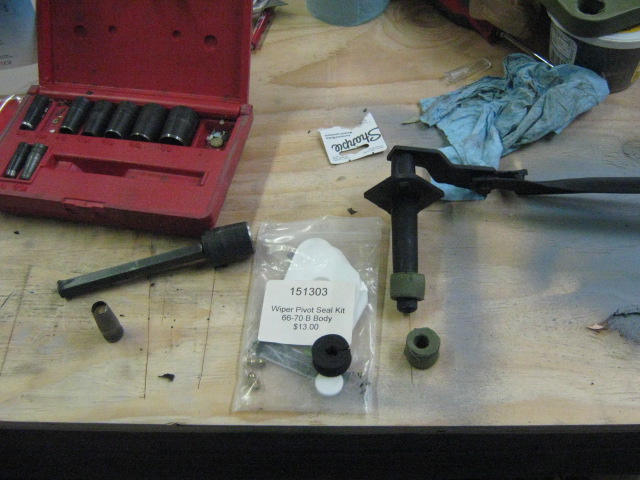

I also bought a wiper gasket/seal refurbish kit from some vendor, can't remember which now, but the black neoprene round seals were a joke. They tore the minute I applied the slightest pressure to get them stretched over the shaft. So I went to Home Depot and bought a gardening kneeling pad. Very similar texture actually a bit more dense but very form-able. Dean has a gasket punch kit so we made our own with better material. That is what the pic of stuff on the bench is.
Looking good great work. I love that seat but could never own anything that clean, as my wife says it "You could ruin a nice set of clothes in your sleep" so eveything I get has to be black.

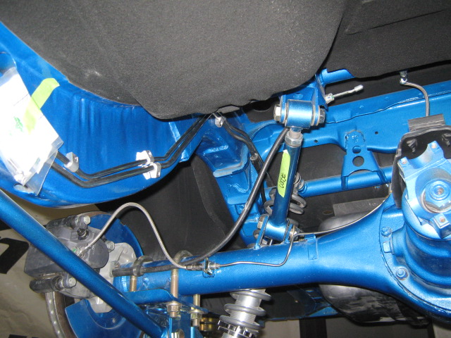

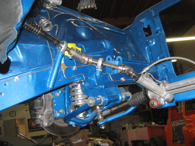

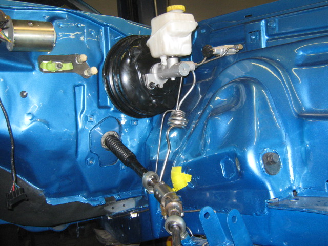

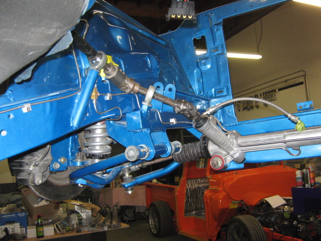

Got the brake and fuel lines installed, all stainless steelIMG_1334.jpgIMG_1329.jpgIMG_1330.jpgIMG_1331.jpgIMG_1332.jpgIMG_1333.jpg

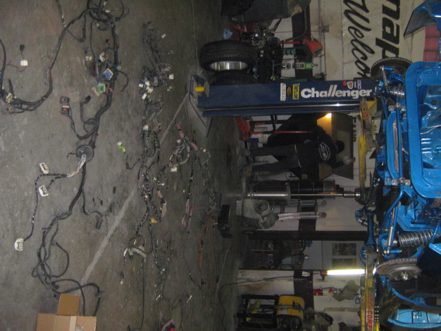

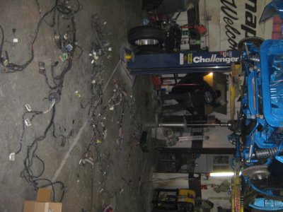

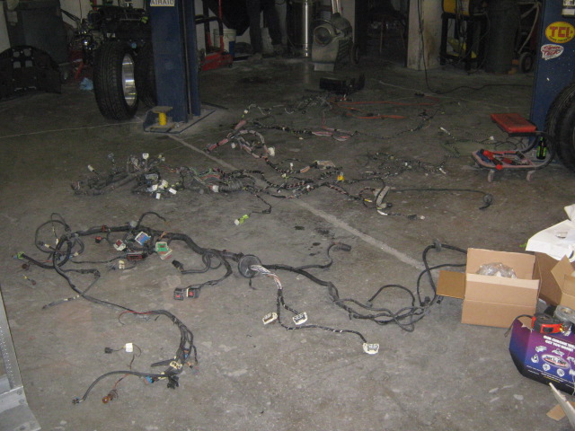

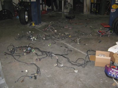

I'll not listen to anyone complain about wiring harness' ever again!IMG_1336.jpgIMG_1335.jpg

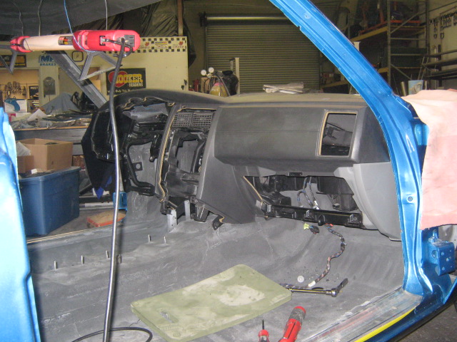

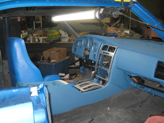

I just had to sit this in there to see how it looks. Decided I'm going to clear coat the dash. It brings that flat blue very close to the B-7 like color they used in the day.IMG_1342.jpgIMG_1337.jpg
Got the massive wire harness routed and am busy deleting stuff I don't need from it. Not as bad as I thought it would be.Dean is doing most of that work so easy for ME to say

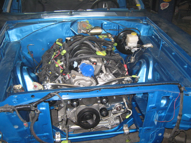

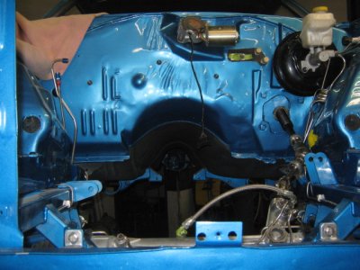

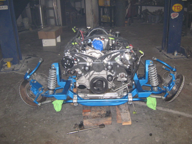

My 5.7's FINAL resting place (finally!)
Went right in as it should seeing as how we had it in already, however, we did not have the transmission dip stick on it during mock up. It fits with about the thickness of a piece of paper against the hump. I could have raised the hump a bit more I suppose, always something.
How COOL Darius . . . So that's what my car "could" look like when the Hemi gets installed . . . WOW . . . I like it ! ! !

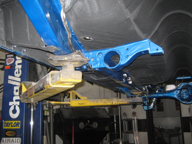

I haven't been following the build as closely as others, but the work looks impressive. I like the holes in the trans crossmember for exhaust routing. Should allow some decent ground clearance for street use, huh?
