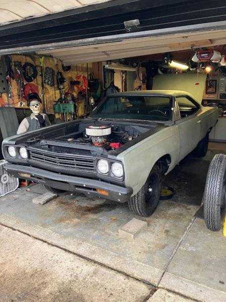

I'm having a recent problem of a backfire thru exhaust on my newly rebuilt 440. This is a 72 - 440 in my 69 Roadrunner. I have read some other threads, but I was wondering if I could start my own discussion on this topic.

Expla.ining the backfire...it is was a pretty good exhaust bang out of what seemed like the passenger side. I running 2" headers into 3" exhaust straight back with glass packs about rear 3/4 back dumping a balony cut tip at axel
