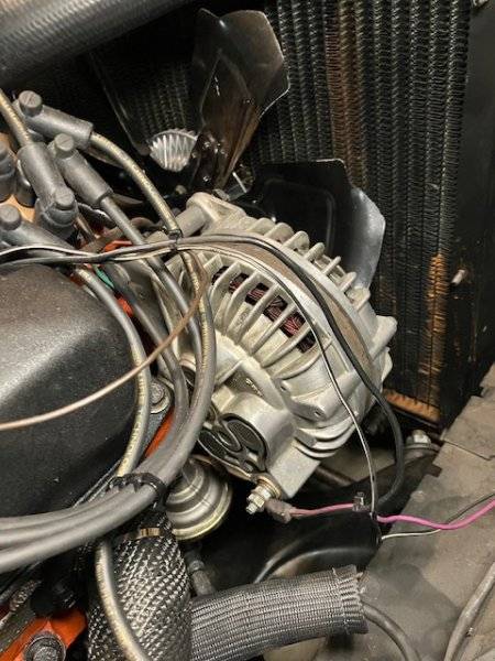

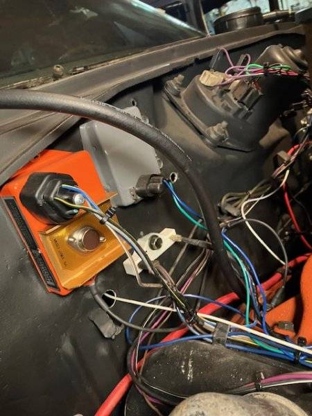

Could a weak negative battery ground be at fault as well?
Just took these pics a few minutes ago, in for the night now.
That photo is not a 69 quarter and that ground is not good,

Thanks for the advise 1stMP. Yes, the 2" headers are kind of a pain. They are so close to plugs, wires, power steering, and mini starter. I may change out to a little smaller in future. I'm running heat wraps on everything. But, combined with the 3" exhaust straight back with glass packs dumping at axle, it does sound good too me and probably not change this summer. Maybe over winter I might. As for the popping, it has not come back once I changed to a power master alternator with the built in regulator. It seems Dadsby was correct in that a single wire 1969 alternator would not work correctly with a post 70 voltage regulator. Have not had a problem since at idle.
