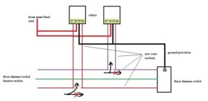

I installed relays just right after the dimmer floor selector, hidden down the kick panel. No need to cut any wire, just relocate the ones running out to bulkhead from selector into the relays 87 terminals, and run a section of same color wire between dimmer selector outputs into the 86 terminal of relays ( trigger input ). Feeded 30 from ammeter stud, black side, and grounded 85... voila. Engine bay untouched, relays protected from enviroment and nobody will tell you got upgraded those, not even looking at the floor selector
HOWEVER get upgraded the charging system with parallel paths from/to ammeter out of the bulkhead cavities ( bulkhead ones can keep in place )

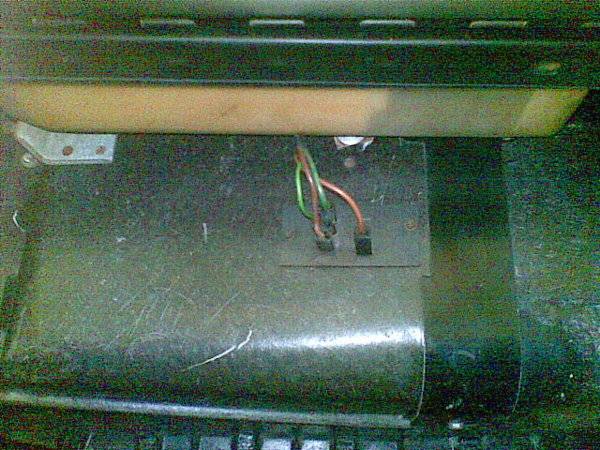

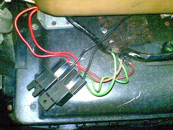

Couldn't find the headlights relay hidden back the kick panels but I did the same for A/C and Heater blower resistor block because the blower lever it keeps overheating and melting the plug... these are pics I took for the low and mid speeds ( heater and max speed are around the steering column ). Relays hidden on back of glovebox, hold by the A/C block bracket stud, just pulled them out to show how it looks the wiring. As mentioned no cut wires, just some adds. You can't tell there are relays there. Plug wires are the same than no relays on system
and as mentioned, the straight path between alt and amm is mandatory for this. Amm and batt could be even optional if you have a decent alt able to give around 50 amps iddling
Sorry the pics quality... they were taken around 6 years ago with an old nokia I had
