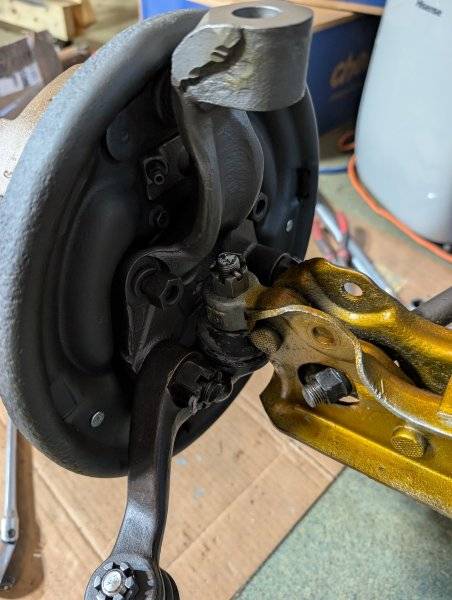

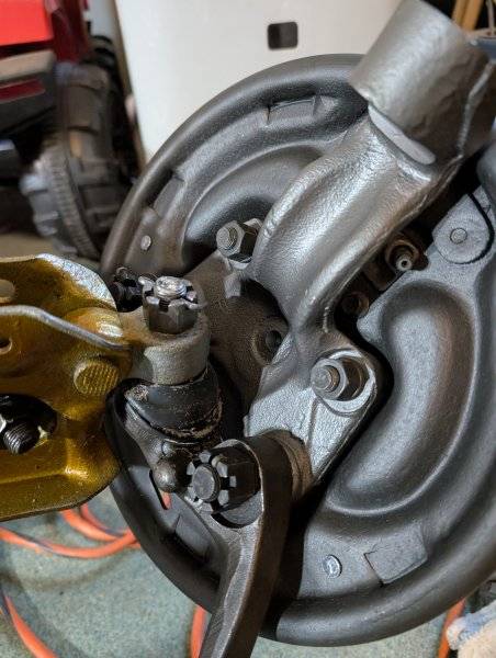

I've been assembling the front suspension on the K-frame. I attached the lower ball joints (both new sourced from the same place) - one feels stiff and the drum stays vertical. The other side feels loose and the drum flops out.
What say the experts - is the "loose" one bad out of the box? While I don't want to disassemble it, now is better than later!
Thanks for your opinions!

Ross what brand did you buy? I have changed a couple and none were loose. Moog is hit or miss/junk nowadays Lets see what the guros have to say.
I'm curious what others will have to say, but my rule is if they're installed, they're good if there's no in/out movement. But if the part is in my hand and I can spin the joint easily with my fingers, I'll reject it. The one you have that's stiff will probably be just like the other one after a few turns with the weight of the car on the ground.
And to add, I've had lower ball joints fail my check within a year going back to the 90's. So the quality has been lacking for awhile now.
I have not greased either yet I'm trying to determine play. It just feels loose - moves easily vs the other. Just collecting opinions.
Should not be loose. Loose means it has clearance.
Thanks - maybe I'm just being paranoid. I'd rather replace now and keep this one as a spare if they are usually stiff out of the box like the other

I think that's where KernDog was going as well. As soon as I wrote that I knew where it would end up! It's supposed to be stiff in the box and loose out of the box :)

on a relative to the topic note...I've never had a loose ball joint out of the box even before greased. And Moog were always super stiff

I believe they are TRW NOS (bought from Craig and not bashing him at all - he didn't manufacture them). I think I'll buy another and see how it feels. I need to put in an order for drums anyway to keep my brakes from getting dusty.
My guess is they are fine, just at the ends of the tolerance - smallest ball with biggest socket and "feels looser". I know it's not a technical term, and while I'd prefer a more Yes/No, On/Off, 1/0 kind of answer or verification method, it's the best I've got so far.
If it were me, I'd replace it if I think it's too loose. As you said, it's easier to replace now rather than a year down the road when it's all done. I just did this on a 72 Challenger. I didn't like the upper control arm bushings I received in a kit so I bought another set and installed those instead. Just my take on it.
