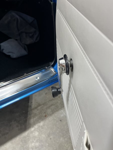

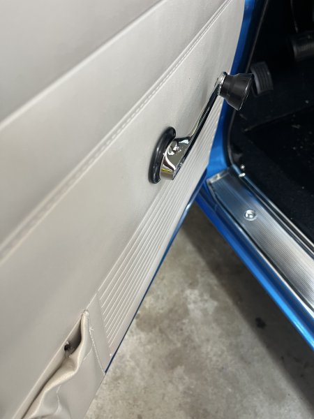

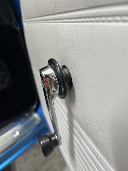

Putting together a 68 Charger, currently installing new door panels, hardware, etc. rear interior qrtr panels went in nice including the crank handles….. but, the front door crank handles when pushed all the way on, leave a 1/2” gap between the door panel and the escutcheon! Car when bought came with many new parts, including all the above. Is this car supposed to have all 4 handles being the same? Or are fronts different? IMG_7599.jpegIMG_7600.jpegIMG_7601.jpeg
Door glass regulators are obviously bolted in wrong.. how I have no idea.
You mean bolted in too close to the inside skin?
The window works perfectly….. this is mind boggling
Looks like the opposite of the normal question.. can I use a 68 charger regulator in a 67?
The 67s are longer for a fat door panel.
Jeeeeez….. seller only removed everything for a paint job and replaced parts back in again…I suppose he could’ve used a 67…
That sucks, you can pull the regulator out and look for a number.

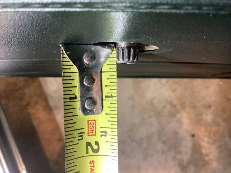

The one in your car appears to be too long. Wonder if it's roughly 9/16s.

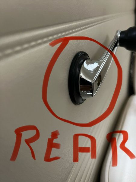

Park any attempt of a connection to the rears , in the back of your mind. We see no problem there.

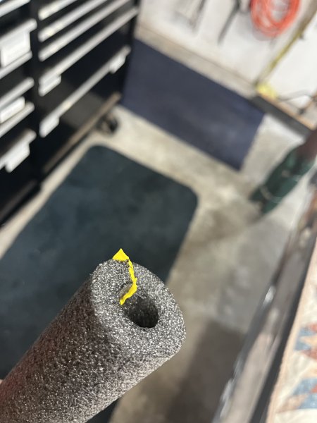

FIXED!!!!
Nothing a piece of copper heating pipe insulation won’t cure!!!
Thanks for everyones help!!!
Not sure if that is a permanent fix with a bowed door panel.
That looks like a freshly restored 68 Charger, its probably a $75K plus car.
Bowed 1/2”…. Minimal difference
