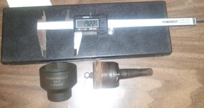

I got mine through Amazon.com for a good price... the set of two (this one and 2 9/64") made by Powerbuilt and come in a case. Kit #32 if you do a search. Oh and yes they are made in Tiawan unfortunately.
EDIT: They are 3/4" drive. I did go pick up a 50" or so 3/4" breaker bar which did make 'relatively' easy work of removing them while still in the car
Actually took them over to a shop where i know some guys and they heated them up and were able to get them free with the 1 59/64 socket i provided.

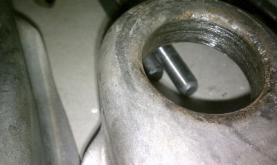

Now, since someone mentioned the control arm threads, here are what mine look like. Uppers look good, but lower looks a bit suspect, not really well defined. Not sure if the ball joints were original to the car, but who knows.
So here is what they look like, one is just a bit better than the other, now the question, can these be re-threaded or chased?
