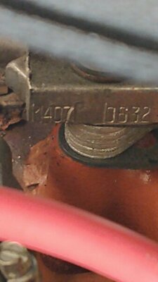

Here ya go:Can you confirm the carb # for us
Before I go off , no pun intended , on the off idle to lean mixture on the Edelbrock AFB 1407/1411 750 Carbs that I have worked on in the past
AVS is a completely different model

I brought that up post #25I am starting to lean towards blaming that "reman" carburetor, to be honest.
