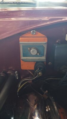

What is the part number on your Orange box? I have several DC charts that show the ballast resistor values. Looks like .5 Ohm or .7 Ohm depending on coil.
Heck I dunno, it just says "Made in USA" on the front as it came from Ma Mopar.
I guess I could uninstall it for a number on the back maybe?
