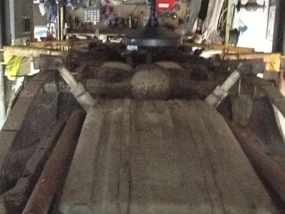

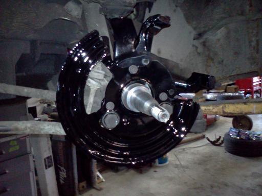

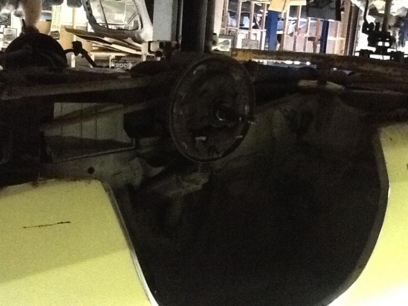

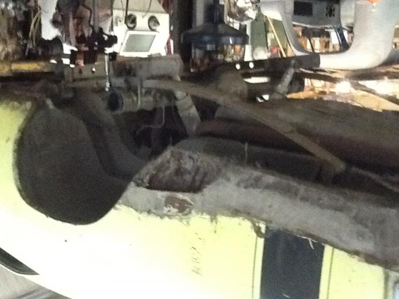

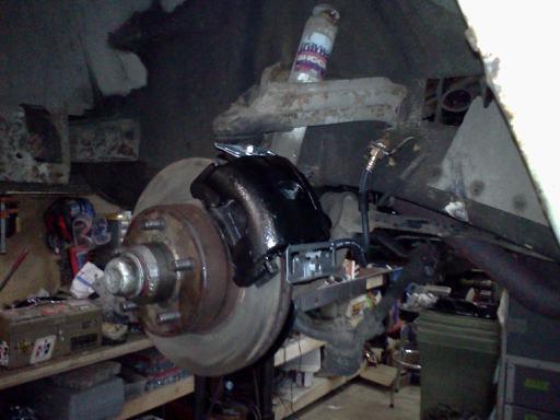

After cleaning and media blasting the front spindles and caliper brackets and buying new calipers, the front brakes from our donor M body are ready to go in place of the old 10 inch drums. We also have some new 11 inch drums for the back. Also purchased a master cylinder and mounting bracket from Mancini Racing, and new proportioning valve. Also changing the rear studs to rh thread. The fronts are correct with the new rotors.
sorry about the pictures, for some reason, the editor flips my IPad pictures 180 degrees.

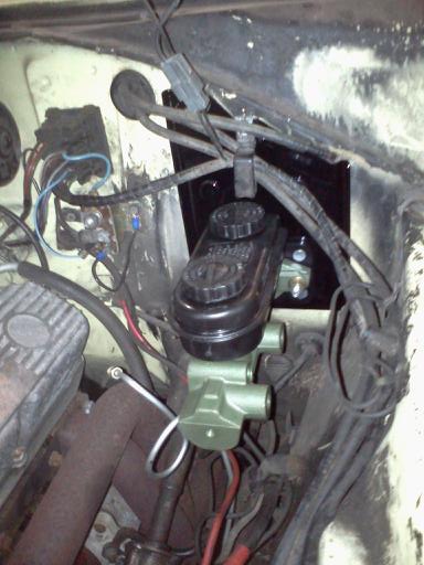

Getting the brakes installed

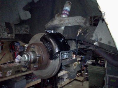

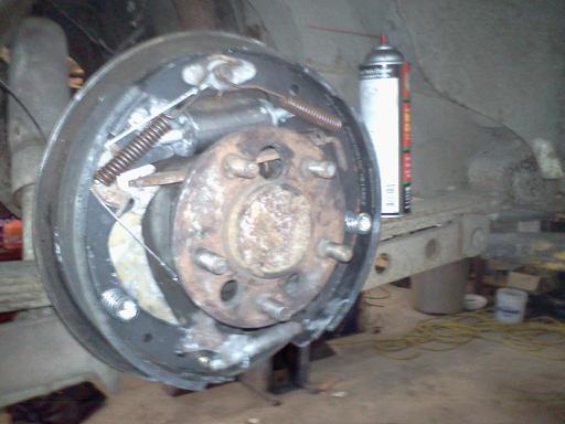

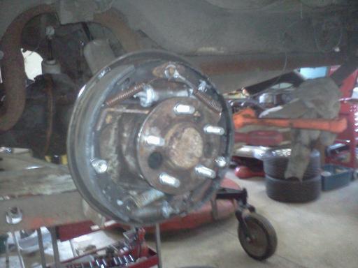

Here is the front disc brake conversion using parts from an M body (any F/M/J would work). The rear drums are now 11 inchers.downsized_0526131555.jpgdownsized_0526131612.jpgdownsized950526131410.jpgdownsized950526131431.jpg
really nice find! first car i ever owned was a 68 charger, still my first love.

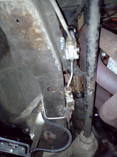

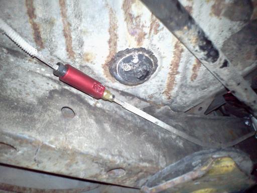

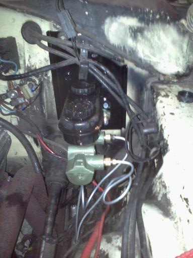

Getting the brakes done. We installed a new master cylinder for the discs and proportioning valve and 10 lb check valve for the drums. Now for a test drive.downsized_0529131802a.jpgdownsized_0529131802.jpgdownsized_0530131732.jpgdownsized_0530132037.jpg

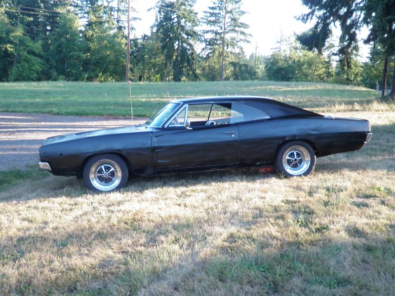

17's. They are a pre production wheel done by Wheel Vintiques that a friend of mine special ordered. They are a bit heavier than the current production wheel, so we got them from him for a nice price. The tires are 255/45ZR17's front and 285/40ZR17's rear, both on 10 inch width wheels. The tire shop had a bit of problem getting the rears on the rims, and ruined a sidewall (another reason we got a good package deal as I had to spend $360 for a new tire). I thought they were going to be too big for the car as we had them sitting under an Aspen initially and they were just a little too much, but under the Charger, I think they look OK.
Well, our summer show season is just about over, so just about time to jump in to the body work. As a temporary measure, and to hide the rust out spots on the body, I did a quickie shoot with Eastwood Rat Rod flat black. It looks much better in one color now.P8170508.jpg
