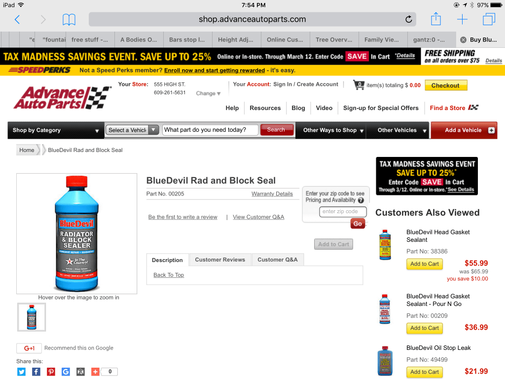

Remove and seal coat the bolt first. Then if it leaks, my favorite sealer is Blue Devil. It works for all kinds of leaks in the cooling system - even head gasket leaks!
