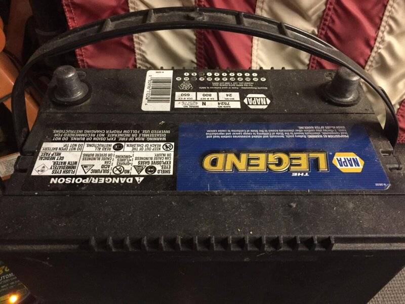

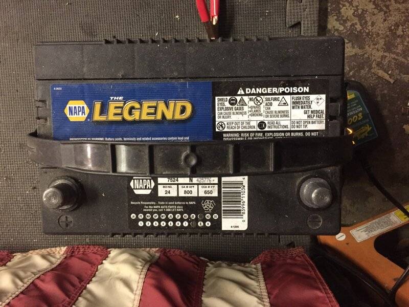

I have NAPA batteries and they are all flat topped and I do not see/feel provisions/bosses for a cap to be pushed in. In addition they have stickers all over them which do not appear to peel off very easily or cleanly.
Pics...pardon the dust lol

Pardon my ignorance, but I am not understanding the snap-in vs glue on. This is not a plate that sits on top of the battery, correct? Do batteries still come with (fake) filling caps?
View attachment 1260541 View attachment 1260542
You will need the glue on caps.
Heat gun and the stickers will come right off............pull them off slowly or else you will have to peal off the stuck paper. Follow up with wax and grease remover.....save the stickers on a piece of cardboard for warranty if/when needed. I got my kit in less than 2 weeks.

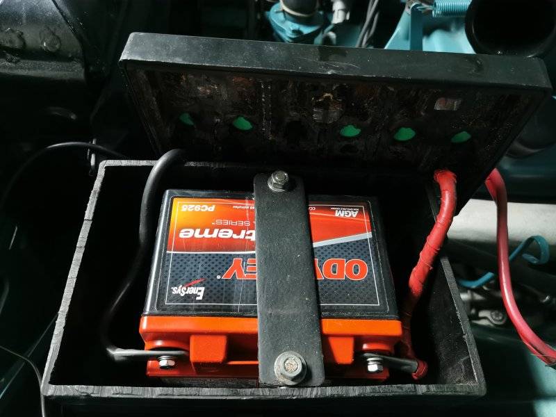

Just for shits and grins...I have an old Red Top repo Mopar battery that died and I saved it. Is it worth the trouble to take it apart and replace the cells in there or stuff a new battery in it or just use the topper and get the new Mopar sticker? I vaguely remember here or on ABO that did it with some success.
:thankyou:
Gut it and stuff an Odyssey PC925 inside it. If you don't think you'll ever do that, drain the acid, flush it with water good, stuff it in a box and mail it to me.. I'll pay the shipping!! :D

A-ha! So it was you who did it! LOL For some reason I thought that there are 6-8 sealed cells in there (?) and it would just come apart without any acid-spillage.

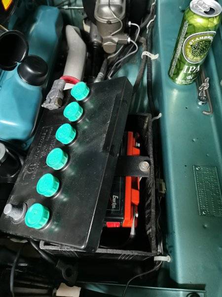

I don't hear any swishing around when I move it, but it came with the car when I got it in 08. So it looks like glue on caps for me! lol Thank you @dadsbee
