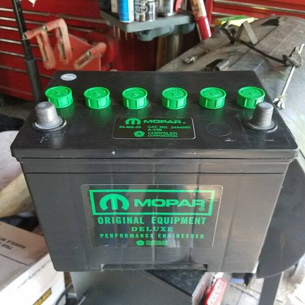

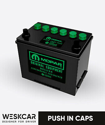

I ordered one of these and it worked out well. I know it's not original and you all know, but how many people can tell this is a Wal Mart battery? I'm not going to tell. Here's a link. They come from Belgium so they take a while to get here. Be patient. They have a good selection of push in and glue on caps in 3 colors and different styles. Check your battery first to make sure they will work.
1/22 Update: there is a embossed "Mopar" side plate available.
https://www.ebay.com/sch/m.html?_ss...12.TRC2.A0.H0.Xmopar.TRS0&_nkw=mopar&_sacat=0
battery topper kit.jpg Battery topper kit3.jpg battery topper kit4.jpg battery topper kit6.jpg

The push in caps were designed to work with 3/4” holes. Also, these were made using an Interstate battery as a test dummy but any battery with the 3/4” hole these will snap right in.

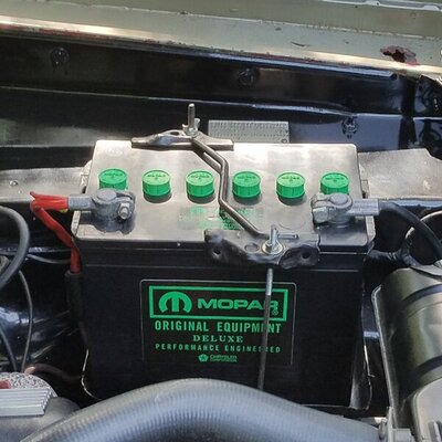

Been running caps for four years now on a battery from Batteries Plus

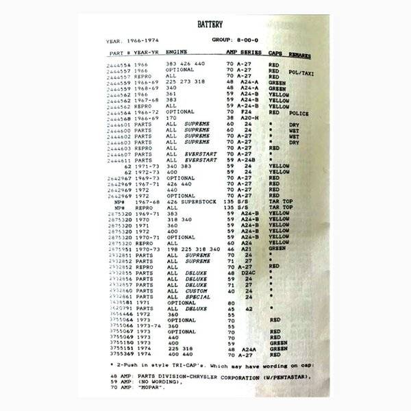

Here's a chart. I will post it above as well:
Green Caps:
  • 1966-1969 with 225, 273, and 318 engines and 48 amp alternator
  • 1968-1969 with 340 engines and 48 amp alternator
  • 1970-1973 with 225, 318, and 340 engines and 46 amp alternator
  • 1973 with 400 engines and 59 amp alternator
  • 1974 with 225 and 318 engines and 48 amp alternator
Yellow Caps:
  • 1966 with 361 engines and 59 amp alternator
  • 1967-1971 with 383 engines and 59 amp alternator
  • 1970 with 318 and 340 engines and 59 amp alternator
  • 1971 with 360 engines and 59 amp alternator
  • 1972 with 400 engines and 59 amp alternator
Red Caps:
  • 1966 with 383, 440 and 426 Hemi engines and 70 amp alternator
  • 1966-1972 Police Units with 70 amp alternator
  • 1967-1971 with 440 and 426 Hemi engines and 70 amp alternator
  • 1972 with 440 engine and 70 amp alternator
  • 1973 with 440 engine and 70 amp alternator
  • 1974 with 400 or 440 engine and 70 amp alternator
1971 Broadcast Sheet On Line 3
Batteries:
The two digits are the last two digits of the factory part number of the battery installed:
20 = 59 amp
51 = 46 amp
64 = 70 amp
66 = 55 amp
67 = 70 amp
69 = 70 amp
81 = 80 amp
1971 Fender Tag Codes
F22 Battery 46 Amp Hour (Series 24 w/Green Caps)
F23 Battery 59 Amp Hour (Series 24 w/Yellow Caps)
F25 Battery 70 Amp Hour (Series 27 w/Red Caps)
Did you guys order and use the push in caps, or the glue on caps?

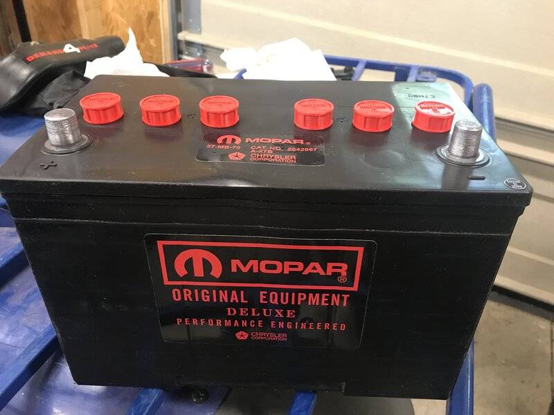

My battery had push in caps (3 caps to a cover) If your battery is a flat top, you will need the glue on caps. Here's a push on cap battery.
I have some Stick on Red caps still if anyone needs a set. I bought a few of each but I do not think I’ll be using them. They take 6-8 weeks to get from the overseas ebay supplier last I heard.
I ordered a set of red push-ons and they came in about a week. They look great and came with a group 24 sticker. I already had a group 27 sticker that I will use.
