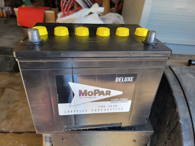

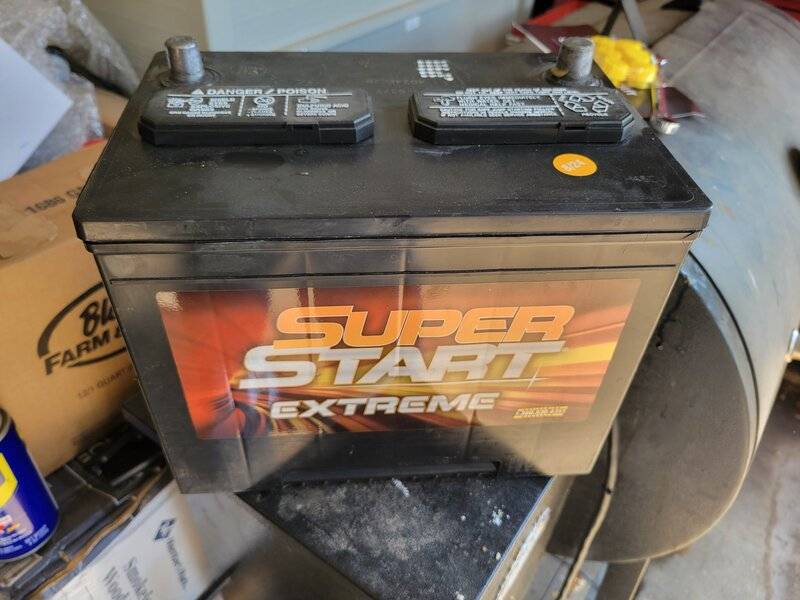

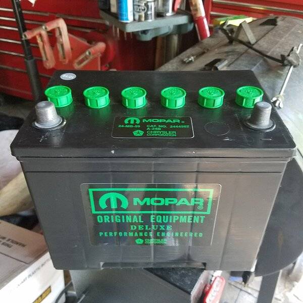

I ordered one of these and it worked out well. I know it's not original and you all know, but how many people can tell this is a Wal Mart battery? I'm not going to tell. Here's a link. They come from Belgium so they take a while to get here. Be patient. They have a good selection of push in and glue on caps in 3 colors and different styles. Check your battery first to make sure they will work.

Here is a chart for what you need.
Green Caps:
  • 1966-1969 with 225, 273, and 318 engines and 48 amp alternator
  • 1968-1969 with 340 engines and 48 amp alternator
  • 1970-1973 with 225, 318, and 340 engines and 46 amp alternator
  • 1973 with 400 engines and 59 amp alternator
  • 1974 with 225 and 318 engines and 48 amp alternator
Yellow Caps:
  • 1966 with 361 engines and 59 amp alternator
  • 1967-1971 with 383 engines and 59 amp alternator
  • 1970 with 318 and 340 engines and 59 amp alternator
  • 1971 with 360 engines and 59 amp alternator
  • 1972 with 400 engines and 59 amp alternator
Red Caps:
  • 1966 with 383, 440 and 426 Hemi engines and 70 amp alternator
  • 1966-1972 Police Units with 70 amp alternator
  • 1967-1971 with 440 and 426 Hemi engines and 70 amp alternator
  • 1972 with 440 engine and 70 amp alternator
  • 1973 with 440 engine and 70 amp alternator
  • 1974 with 400 or 440 engine and 70 amp alternator

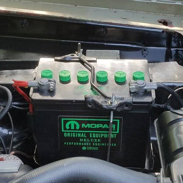

They don't make the screw in caps that I know of. Batteries either have the push in's or they are flat top maintenance free. For those, they have glue on caps. Wescar may have screw caps but ytou would have to check with them if you would need them. Here's the battery in my 64. I am not a fan of the look and colors but it appears to look like an original. Before and after.
