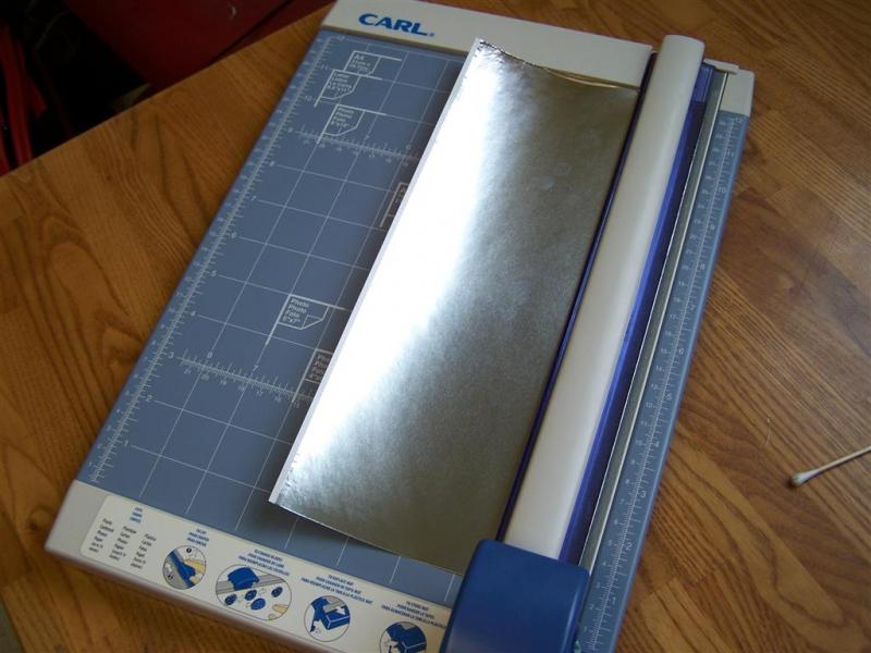

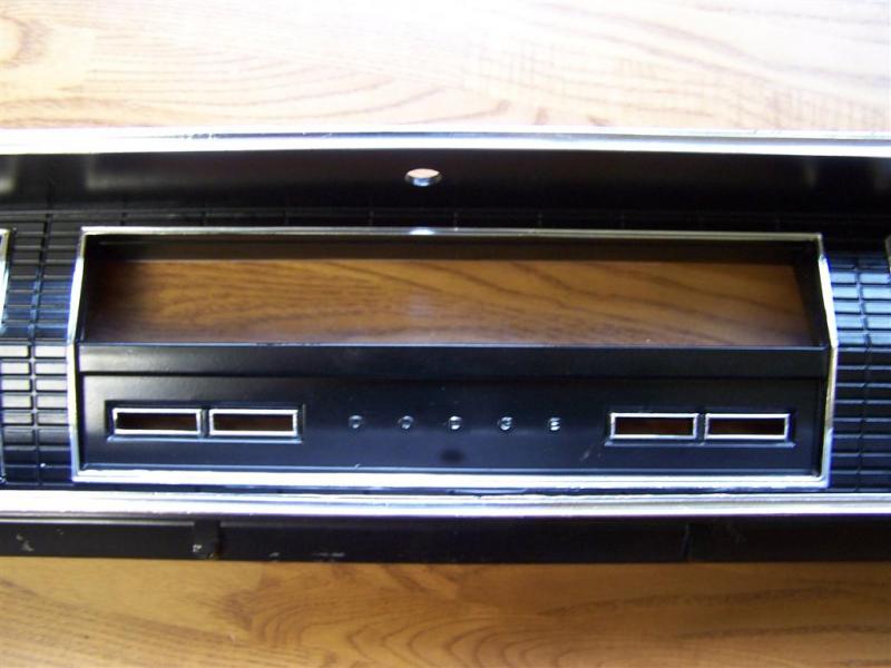

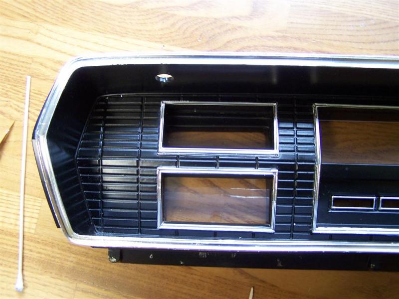

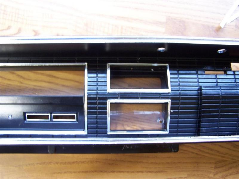

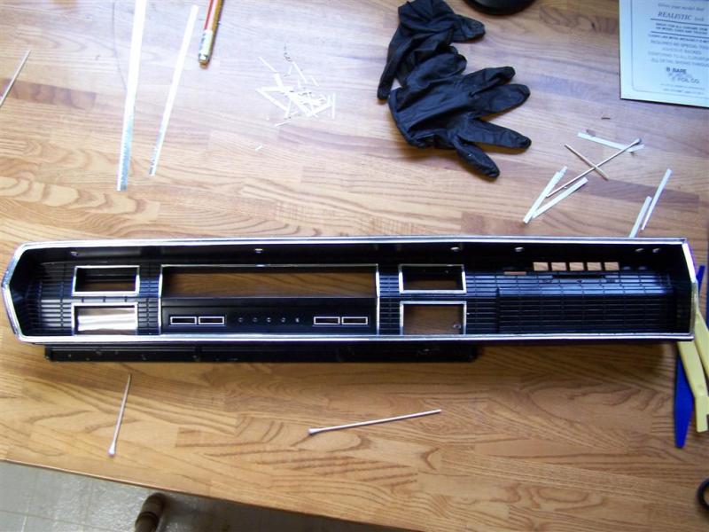

The BEandA stuff is amazing in person. If our Coronet 500 wasn't a driver I would have used that stuff. As far as restoration you will have to call around. I had great luck with Bare Metal Foil and some silver paint on a q-tip for our bezel.
100_7333 (Large).jpg100_7334 (Large).jpg100_7335 (Large).jpg100_7336 (Large).jpg100_7337 (Large).jpg100_7338 (Large).jpg
Wow that looks awesome, not sure if I have the talent/patience to pull that off.
PG Classics which sells the same stuff but in Canada has a cluster ans lens deal on e-bay thats $100 less the catalog price.
I thought the same thing when I started. It is super easy and only took me part of an afternoon. Bare Metal Foil is very forgiving. If you want I'll send you a section of what I have left to mess around with. Hit me with your address and I will put it in the mail box.
Looking at the pictures I realized that they were taken prior to painting the letters (hi, lo, D-O-D-G-E) silver FYI.
