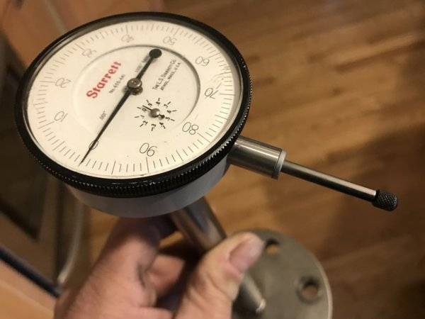

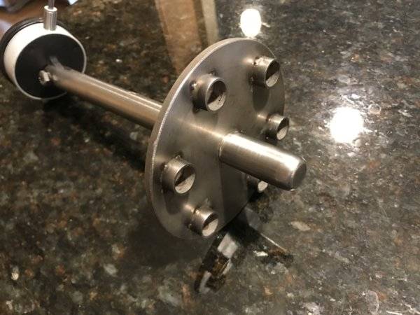

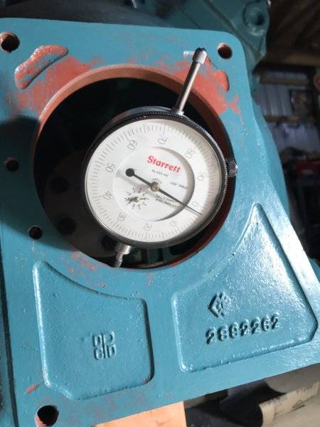

I was .010 out.
Bought some Robbmac offset dowels in .007 and got it to .003 runout.
