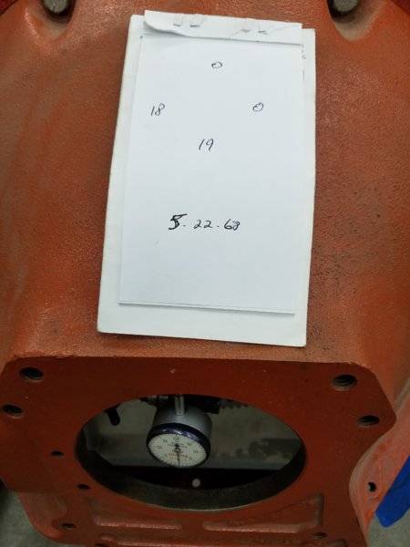

I have never played around with bellhousing alignment, but am trying to learn. So am I thinking correctly that in a perfect world I would need a pair of .009 offsets? Seeing as though they are only sold as 7, 14, or 21's. I should buy a pair of .007's?

great topic i will doing this in a few weeks had no idea how to do it,what dial is used to determine index,how is the procedural done with dial i have to buy a dial how is it used?for as numbers goes.
If you are buying a dial indicator for this job, the 1 inch models are easier to get set up in the limited space.
Thanks again 493 Mike. Didn't see your recommendation at first, but just got a set ordered.

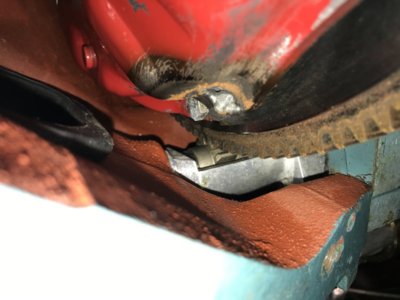

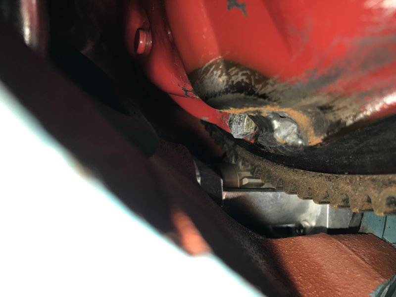

Maybe you have this sorted out as well Hunt, but I’ll throw it out there anyhow.
I bought a brand new McCleod clutch and a Hays SFI flywheel for my car. All “neutral” balanced from the manufacturers.
I took it all to my machine shop to have it checked and we found that the flywheel was slightly off (needed touched with a 1/2” drill bit to bring it to neutral) and the pressure plate was way off (needed an ingot welded to it to bring it to neutral).
It cost me about 100 bucks to balance the two.
I’m glad I took them in as opposed to trusting that they would be ok and having a drivetrain vibration.
