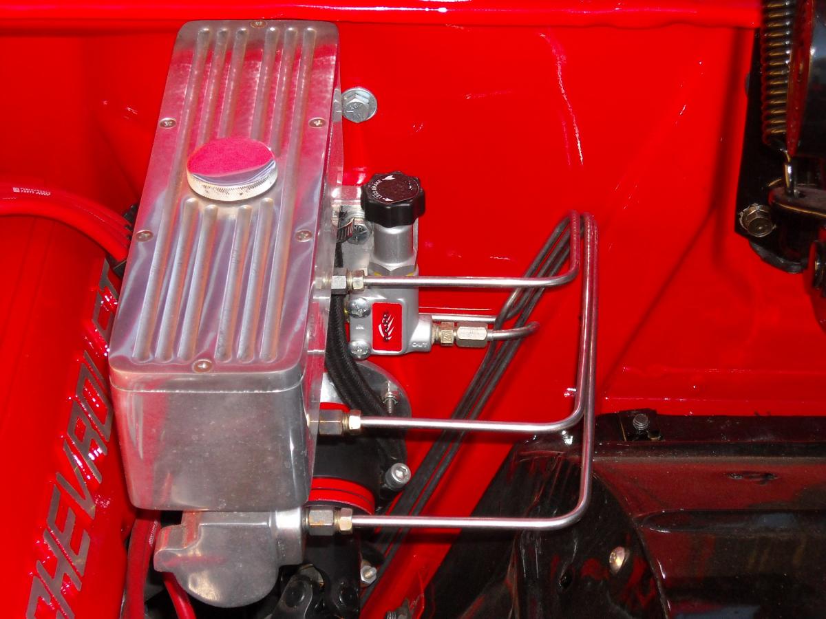

I see in one of your pics you have the proportion valve mounted in about the same spot as I did mine.

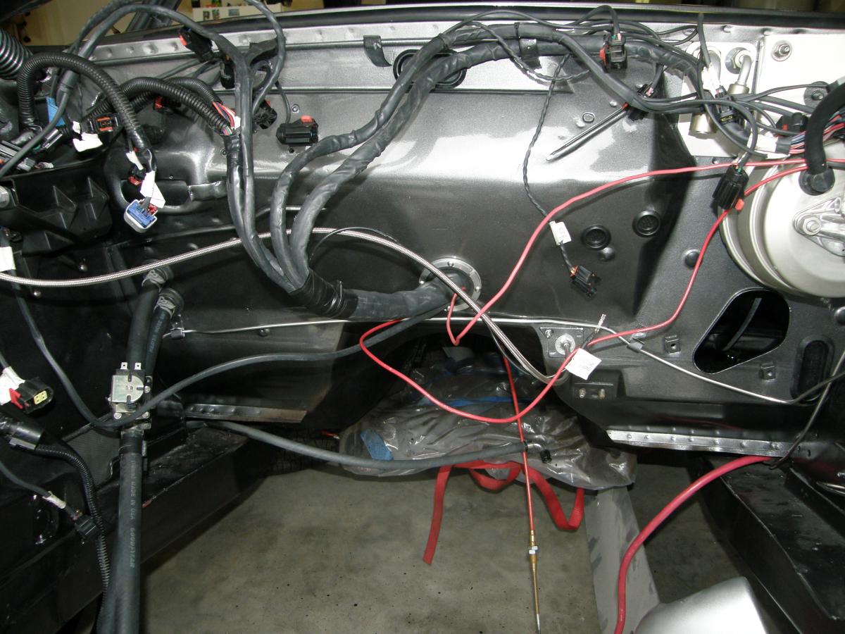

This what I ended up with, a 2 piece line. After some thought, this will make a great pattern for the 1 piece tube that will get here next week.
That's a really nice job. And yeah, just use that two piece line as a template, you'll be just fine.
I bent up the lines for my rearend - I feel your pain. There is an art to that kind of thing - and the more you do it the better. I did it twice - LOL. The second set is working ok, but still not too pretty. Luckily it isn't seen by most people. I'll probably do it over again some time to try to make it better. Yours look decent to me.
That engine bay look stellar 5.7. The color just knocks it out of the park. Brake lines came out pretty damn nice.
I bent the new 1 peice line and got it installed, looks alright. Once the eng/trans goes in most of it will be hard to see, also the ac hoses and wiring to headlights/fans/horns will "swallow up" the drivers side, but in a tasteful manner....I hope!!!! I'll get pics of the new line posted tomorrow.
Heres the new 1 peice brake line.
