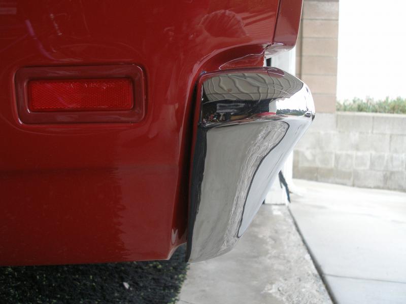

i got hit in the very left corner of my rear bumper, and am wondering if it can be pulled out without taking it off the car. (thinking come along or similar), it's pushed in about 1 inch. other than that, the bumper is in original mint condition.
69roadr, I would call one of your local dealerships and see if they have a BumperMan that services them. I know we have several Bumpermen n California. I have had success n working on older bumpers for people n the past.
My wife bent the front bumper on our Durango recently and I was able to take a 2" tie down strap with a flat hook and ratchet it back out with a bit of work.
without seeing the bumper face............ if it has no kinks or eyebrows take a good look at your mount brackets / braces before pulling any on the bumper.
looks like it needs aprox 1/2"down and 1/2 to 3/4" outward adjustment.
the mounts / brackets have some adjustment and I they were not good and tight it may have just moved on the frame rails.
may be worth a look.

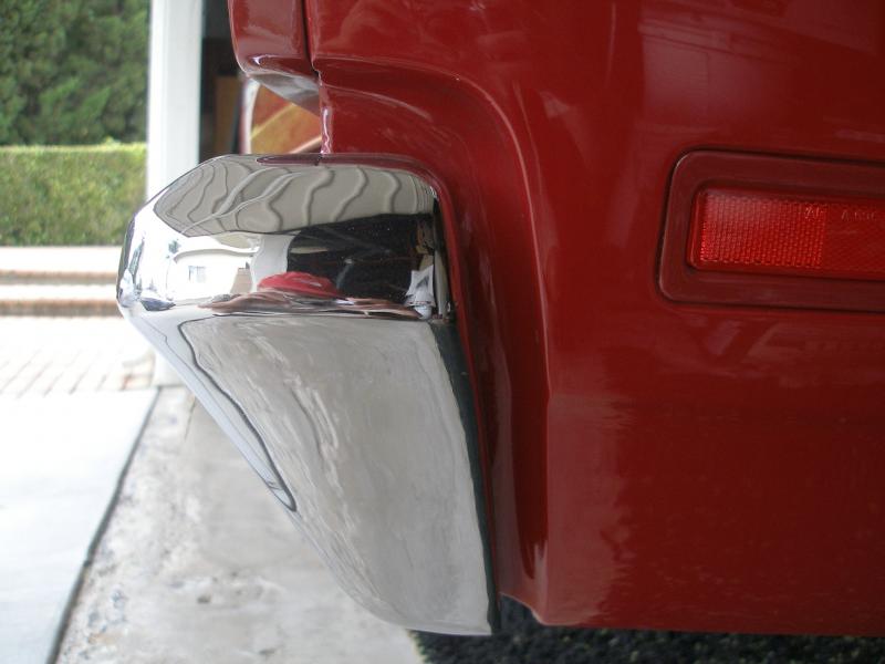

I had the exact thing on my rear bumper corner after parallel parking in Gold Country one day. Some moron gave it a good corner shot. Don't know how it was done, but a local body guy pulled it out and you cannot detect anything. Perfect identical spacing now on each side.

yep, i looked under the car where the bumper bracket is attached, and sure looks like it could be moved out some. other than that, it is still slightly bent just to the left of the two vertical attaching bolts. my game plan is to loosen the mounting brackets and pull the bumper out as far as i can get it, and slip a 2" tie down behind the bumper and try that for now.

69roadr, Glad to hear it is just a slight bend. It may pull out nice if you brace it right at the spot of the bend before you pull. I hope it pulls out nice & straight for you.

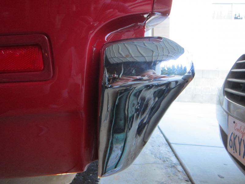

don't know. was parked at a local auto parts store. when i opened the trunk is when i noticed it had some black paint on the corner. didn't notice the bend till a few days later. I ended up using a 3000 lb. tie strap to pull it out with the frame of my Chrysler T&C. (thanx Cranky)
before
after
Man.....some coward never the less. Gutless. Good to hear the new Chrysler help get the old Chrysler back to tip top shape. Looks good.
Again pretty close but I'm **** when it comes to this stuff. Maybe a block under the corner and floor jack to take the 1/4" of "low" out of it? Or leave it alone and call it good?

yea, i'm pretty **** too. tried the jack under the corner to get it up a bit more, but no go. just gonna leave it at that.
