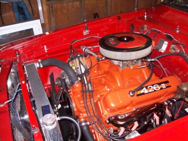

We use Eddy heads on my sons 400 with TTI's and I use TTI's with my Indy EZ heads which have angled plugs. In fact the angle plug makes it better as it moves the plug wire away from the header tubes. My EZ heads flow 345 @ .600 and 339 @ .500. They have only had minor port work. I have not run my car with this new eng yet. Ron
This is my Indy EZ heads with TTI headers.
I haven't had any fit issues with the angle plugs on my stuff.I have seen a few with issues,they were all on the drivers side.The brand of headers ?.I know tti at one time had an issue with them and column shift.
