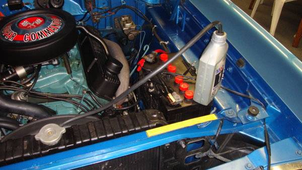

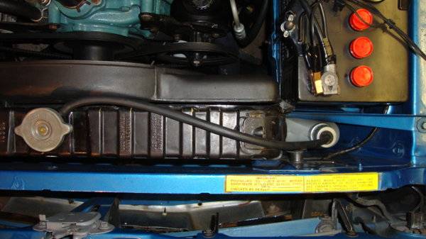

agree with the 2" rule but I'm using a $5 walmart travel cup.
It's frosted translucent clear with a dark gray gasketed screw in lid, has a click closed flip lid to fill, and is graduated.
Kind of looks like it belongs there.
Verified to work.
In fact, the factory overflow tank in my Dakota, integrated with the fan shroud, cracked. They are $125 and up to replace, so I put the $5 walmart cup in there too, and it works in the cross-flow system as well.

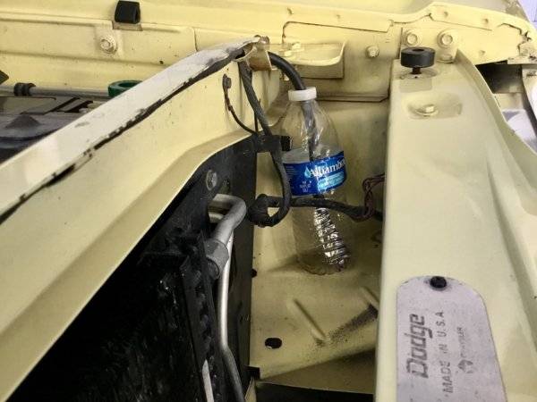

If you don't have the $5, there is always Alhambra.
Dennis....is your car an export?
Yes, in addition to the 1 of 1 recovery tanks.
