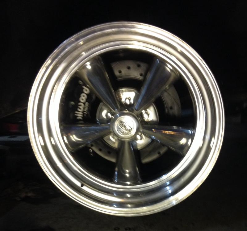

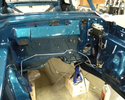

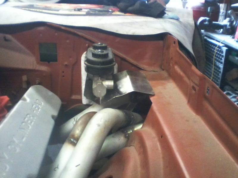

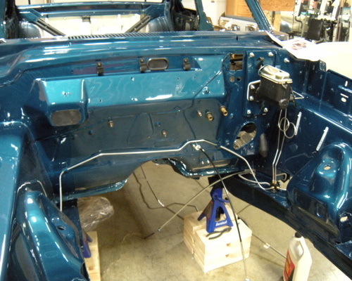

I am running the Mopar perfformance one with the even size rez. You will need the 4 to 2 bolt adapter also. I have a new adapter if you need one ? I am running 4 wheel welwood disc's on my car. Master shield.jpgrr master.jpg
master power. 1-1/8" bore. I'll get you the PN tomorrow.

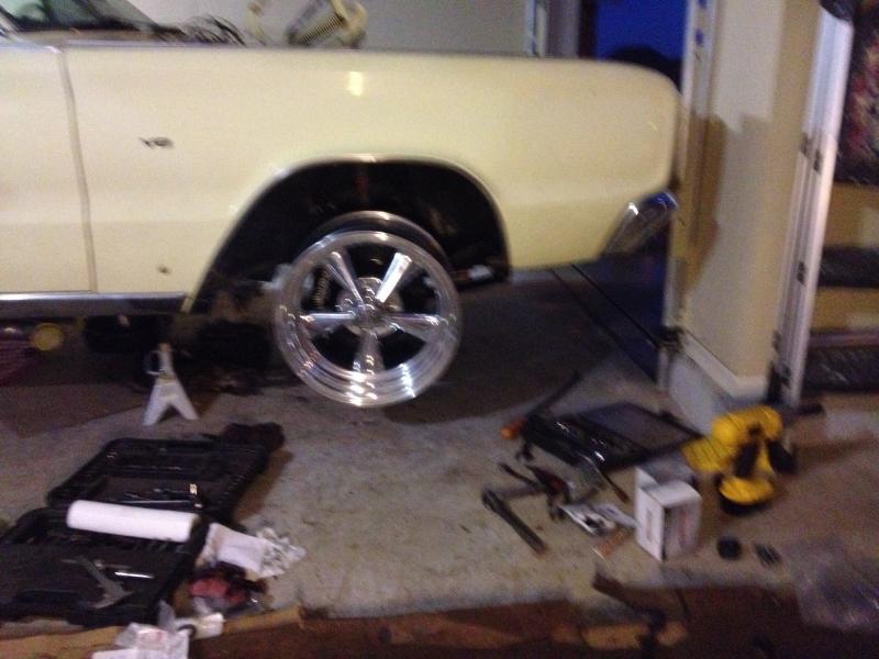

I have the Wilwood 13" rotors with 6 piston calipers front and 12" rotors with 4 piston calipers rear. I went with a Wilwood master in the 7/8 bore. I called Wilwood tech support to insure I got the correct master for my setup.

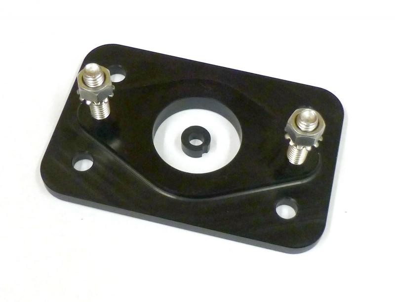

I had to buy a 45 dollar adapter. I was (am) unsatisfied with the quality of the part so I may be making another one. I want to press in the bolt studs from my original master cylinder and celan up the outside edges. The piece I purchased was plazma cut and painted or powder coated. It looks decent except the edges are not finished. Plus using nuts and bolts will be a pain in the butt during install.
mc-adapter.jpgTheres alot of them out there thats why I got this Billet one with pressed in studs. Its a nice part and is what I would have made if I wanted to but there not that costly. The one i have is new and just used for moc up. But heck I only want $35. for it .View attachment 178732
I just made a bunch of these on my CNC mill last week.
I shipped out one to a fellow member on Forabodiesonly so he can test fit it on his car and make sure it will work and then i will post them for sale
He requested his to be bare aluminum but i can get them anodized black just like the dr diff ones and the Mancini ones.I will try and get a pic up on here and also start a thread when i know everything is good to go.
Cost will be $28.95 Canadian plus shipping so i will adjust the price lower for my American friends to make it fair.
