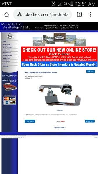

Murray Park has some for $75.00 BUT they are repop. May I however suggest Tony's Parts in Delaware, or Mopar City that is closing down. These 2 will have originals...
