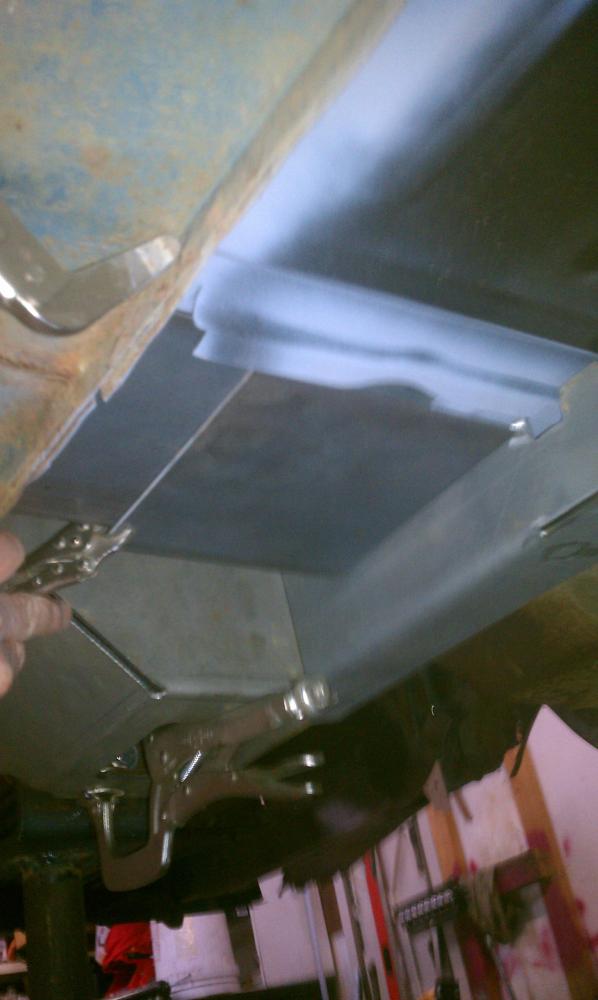

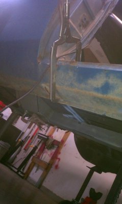

I got a Jegs 8 pt that I am just now trying to figure out the best way to mount the main hoop. I am not installing it yet but planning ahead so I don't mess up. I thought about using 1/8" thick- 6" x 8.5" plates under the floor (nhra requires 6 x 6 on top). They look to be a perfect under the floor seem lap edge and will weld to rocker and sub-frame connector. I will also cut a piece of 2" x 2" or so steel box, cut at an angle to brace under them. Then bolt and/or weld the 6" x 6" plates on top of the floor or cut a 6"x 6" hole in the floor and recess them to fit flat/flush with under plates/braces. Here are a couple of pics that may give you an better idea of what I'm talking about. I used 2- 6 x 6 plates in the 2nd pic just to help show my plan since I don't have any 6 x 8.5 yet. What do you guys think?

from those photos it looks good so far
