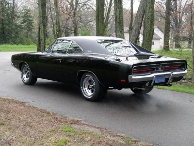

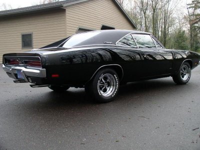

Second gen Chargers look great with 15x10's and 295/50/15's on the rear. Backspacing has to be spot on though. I ran those along with 245/60/15's on 7 inch rims on the front on a couple of Chargers.
275/60/15's on 8 inch rims are also popular for the rear.

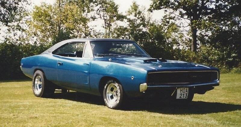

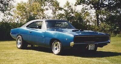

How did it look with the 10's on the back? Any old photos maybe?

I went with 305/45/17 in the back and really like it.

Front disc/rear drum. Rear end is the stock Dana 60. Backspacing for the rear is 5 1/8" and 5 5/16". That put them exactly centered. I am sure that 5 1/4" would have worked as well. Cragar, who now owns the Keystone brand has opened up their custom backspace ordering on these wheels again. A guy almost has to go the custom route with 10" in the back. They are not unreasonable as far as the extra cost. I have ordered 4 sets from them.
