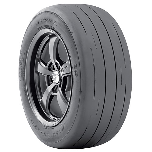

So now I am going to try some Mickey Thompson ET Street Radials Rs. These are a new version of their street legal drag radials.
