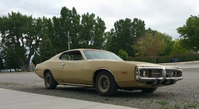

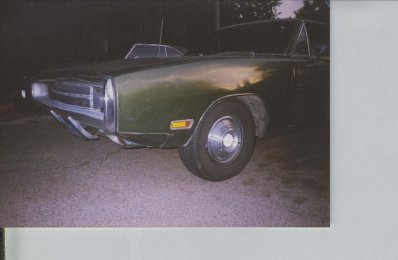

I'm in the middle of the restoration of my 73 Charger, and I want to redo the underbody of the car before final bodywork and paint. From what I understand, it's best to take a heat gun & putty knife to remove leftover undercoating. But then what? I don't have any access to media blasting (life in wyoming.... town of less than 300 people, in the middle of nowhere...). Should I just sand down the underbody to bare metal? Prime it? Or just undercoat it? What products do y'all use and what's the preferred process?
When the car is finished it's only going to be driven during the summer, but I want to prevent any possible rust in the future. Thanks. - David.

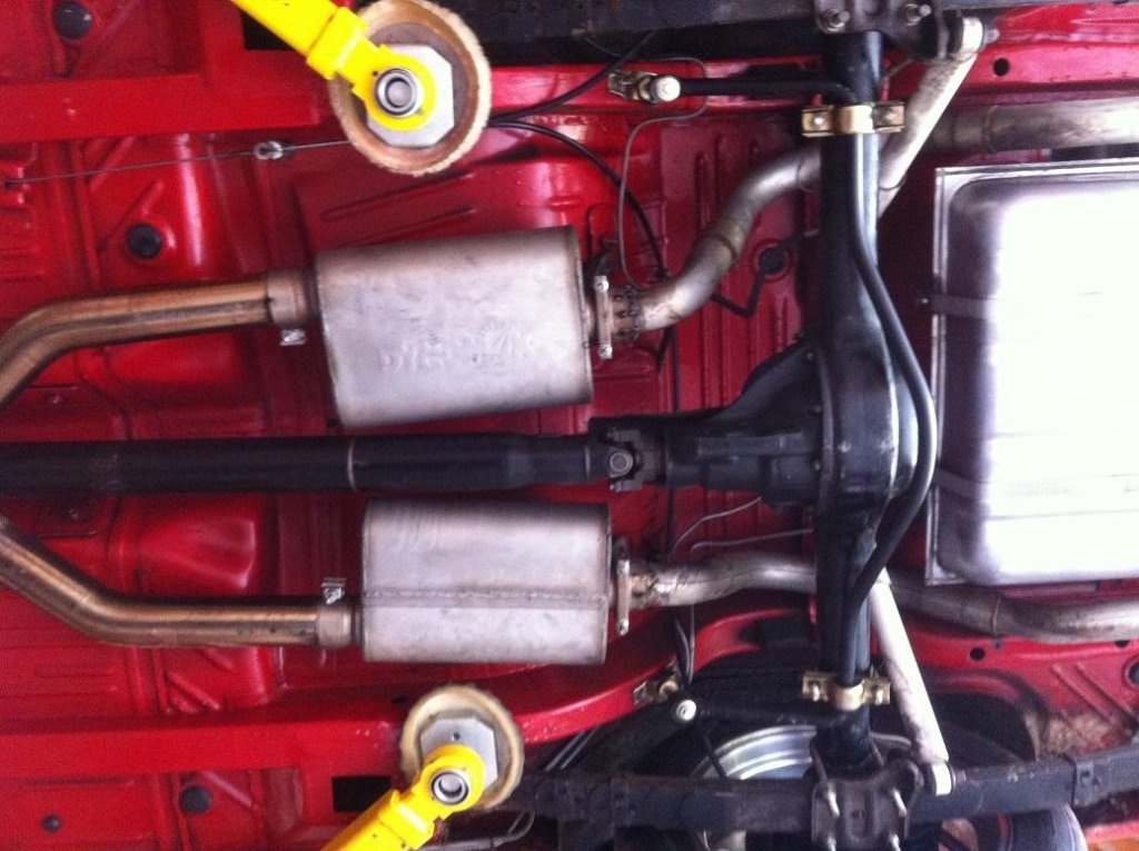

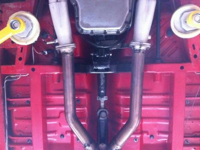

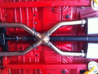

I liked the look of a painted underbody so I went overboard. I was lucky to have a NON undercoated California car that had very few engine leaks. I used Scotch Brites and tooth brushes along with "Castrol Super Clean" in a 3 gallon bug sprayer. The underbody was sprayed and scrubbed in warm weather and it dried quickly. I never primed anything... the floors were so clean I just fogged on the red enamel in several coats. The paint still is sticking...

View attachment 404558 View attachment 404559 View attachment 404560 View attachment 404561

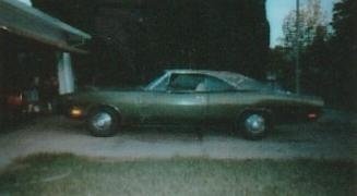

March 12 2000, 17 years ago this week I bought the car for $1700 as a running, driving, currently registered car. I used it for work fora month while my truck was down. 130 miles per day!
Deals like that are long gone. Yes, I was lucky and appreciate my blessing!

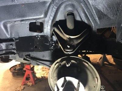

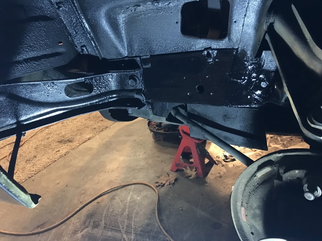

I used an air chisel and needle scaler Set at about 40 psi and just knocked the undercoating off the sub frame rails then painted them black, sprayed over the existing undercoating to give it a new look.
