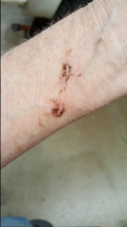

I had a chunk of hot tar drop off my putty knife the last time and it found its way down my sleeve. It sticks and keeps on burning!

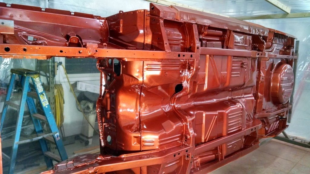

It's a Lot of work and even when there done you always find more ro do it's what keeps us going. I just finished removing the brake and fuel lines now I start the dreaded under body dance

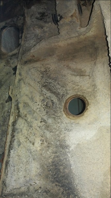

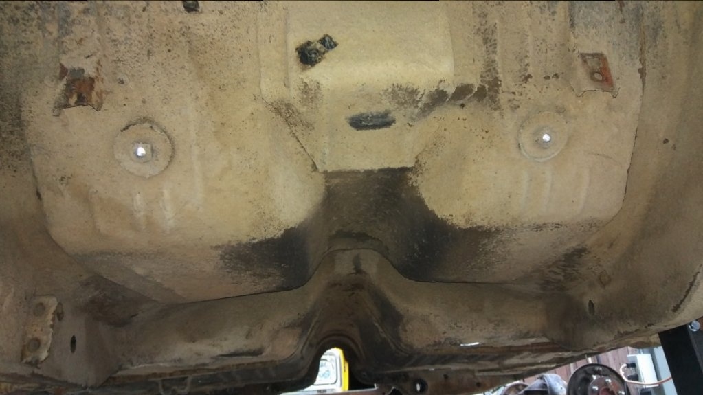

I've spent quite a few hours this week with the heat gun and a bunch of scrapers. It's coming along slowly, but surely. One thing I've noticed, which should be common sense, is that wherever the factory didn't spray much undercoating is where the car has rust issues. I'll be sure to get plenty of coverage when I re spray the undercoating. I just want to get the underbody to bare metal, cleaned, primed, then undercoated. My biggest fear is to find a rust bubble a couple weeks after its back on the road. I have seen "rust encapsulating undercoating available from eastwood, but I don't trust a product that "magically cures rust". So the underbody is going to bare metal, first.
I am currently doing the undercoat removal dance on a 64 Belvedere. I found it easiest to soften the undercoat with a heat gun and use a oscilliating ( vibrating ) tool from Harbor Freight, about $15.00, with the included scraper tool. The scraper can be resharpened or new ones are 3.00. Old age requires that you sometimes take the easy way.
