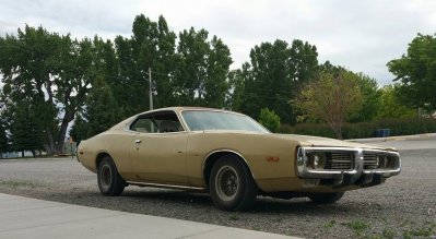

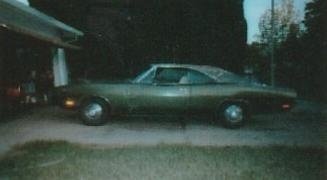

I'm in the middle of the restoration of my 73 Charger, and I want to redo the underbody of the car before final bodywork and paint. From what I understand, it's best to take a heat gun & putty knife to remove leftover undercoating. But then what? I don't have any access to media blasting (life in wyoming.... town of less than 300 people, in the middle of nowhere...). Should I just sand down the underbody to bare metal? Prime it? Or just undercoat it? What products do y'all use and what's the preferred process?
When the car is finished it's only going to be driven during the summer, but I want to prevent any possible rust in the future. Thanks. - David.

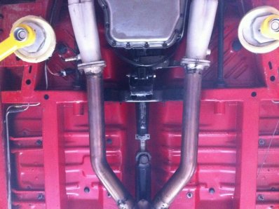

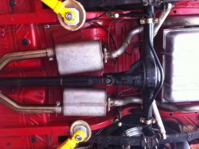

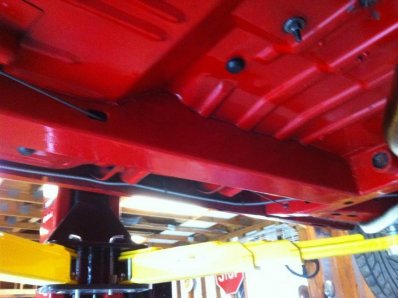

How nice do you want it?
Some cars were undercoated from the front wheels all the way to the rear bumper! That would make it easy if you wanted to replicate the look. You'd just clean the areas that had damage or flaking of the undercoat and reapply more of it. No car ever came from the factory with a fully painted floor pan. They were dipped in 2 vats of primer then sprayed with machines. The underside got paint at the rocker panels and whatever overspray found its way to the floor!

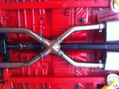

I liked the look of a painted underbody so I went overboard. I was lucky to have a NON undercoated California car that had very few engine leaks. I used Scotch Brites and tooth brushes along with "Castrol Super Clean" in a 3 gallon bug sprayer. The underbody was sprayed and scrubbed in warm weather and it dried quickly. I never primed anything... the floors were so clean I just fogged on the red enamel in several coats. The paint still is sticking...

View attachment 404558 View attachment 404559 View attachment 404560 View attachment 404561

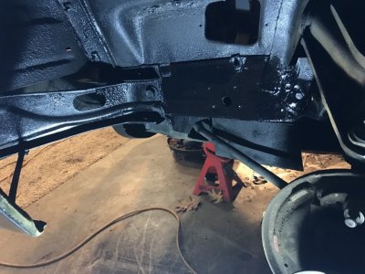

I used an air chisel and needle scaler Set at about 40 psi and just knocked the undercoating off the sub frame rails then painted them black, sprayed over the existing undercoating to give it a new look.
