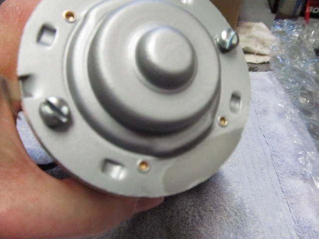

On 3/12/16 I sent my original motor to Kim for restoration of that motor. On 8/27/16 the motor was shipped back to me. Meanwhile this was after countless emails, phone calls, long wasted babbling conversations, excuses. Got the motor looked good(at least what I initially thought) and packed it away.
Time goes by and I had some dealing with an Ex partner of hers and that deal went South! That prick Jerry Schmidt, Concours Creations damaged my parts, some beyond repair and I had to pay hefty to get those parts back. Subsequently, those parts had to be sent to another place for what they should have got done in the first place.
Then it got me thinking about these two and especially her.....So I decided to take the motor apart...

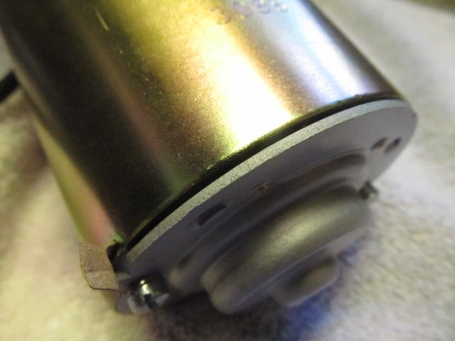

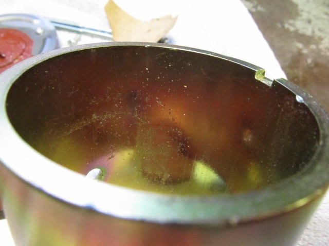

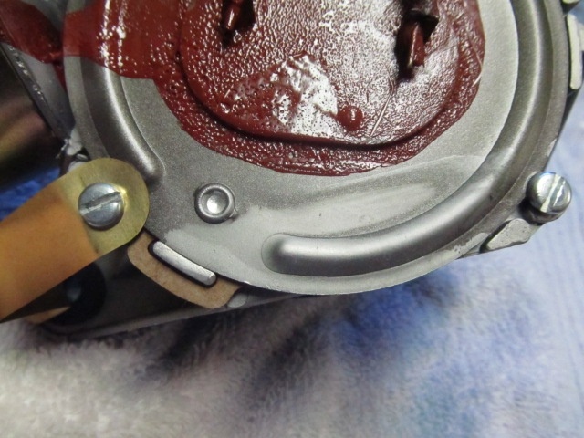

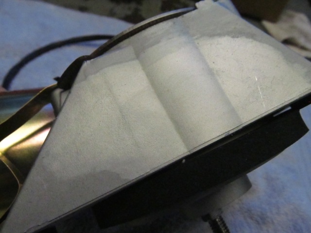

The internals had glass beads throughout. The end cap was painted not plated and had a gap at the end, so it was not fitted back up properly. A little lacquer thinner wiped the paint off. The main casing which is cast was painted as well and a little thinner wiped it off also...
345.00 plus shipping down the tubes for the restoration of my original motor.....
Guys BEWARE!
