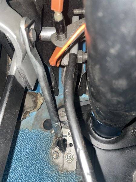

I used an American Powertrain hydraulic throwout bearing in my '68 Coronet. I didn't have any mechanical linkage either as it was converted from an automatic. No overcenter spring required since these hydraulic throwouts are all diaphragm type clutches. I loved it, worked awesome. Smooth, linear action and no "hitch" like with OE setups.
I used the factory pin on the clutch pedal so there was no guessing on pedal ratio. A.P. provides a rod end, threaded rod and coupler setup to actuate the slave but it requires drilling out the factory clutch rod pin to mount it. Drilling out the pin on the pedal is a PITA so instead I cut an OE clutch rod down then drilled and tapped it to attach to the coupler/threaded rod. Worked perfect.
I mounted the master cylinder reservoir here.
Setting up the master cylinder and bracket on the firewall was a bit of a pain but everything else was pretty straightforward. There is more room in that area on trucks than there is on passenger cars so it should be no problem.
