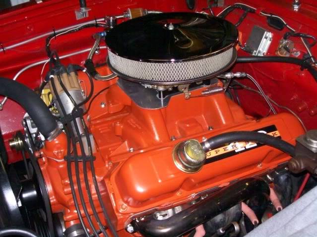

Something for you to consider is the Indy dual plane. It sits a little higher then stock but wow does it flow for a dual plane. I use one on my eng as you can see it here in the pic. You can get then with stock or max wedge ports. With a big enough air cleaner maybe it would pass for stock and I an pretty sure it will outflow the Eddy RPM intake. Ron

Ron, I'm sorry buddy. That's just total badassary. I'm wipin the drool up.
