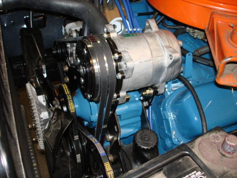

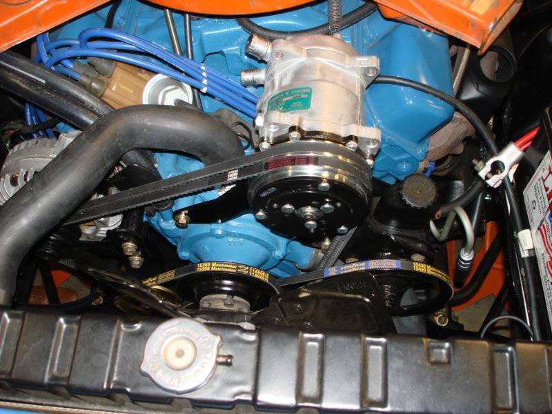

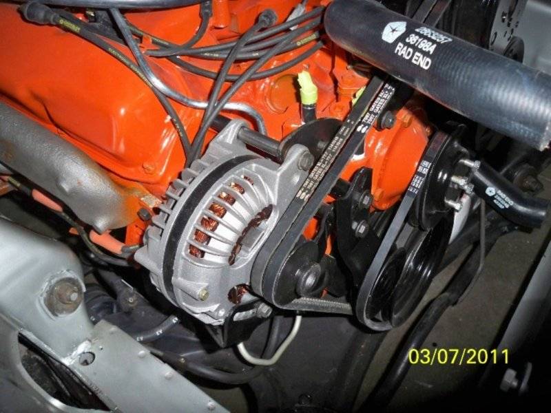

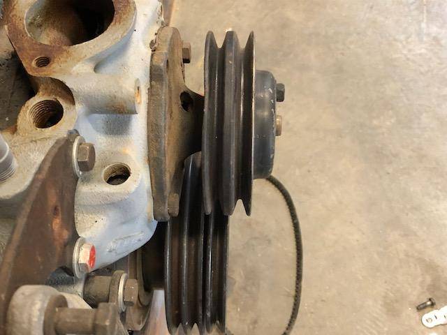

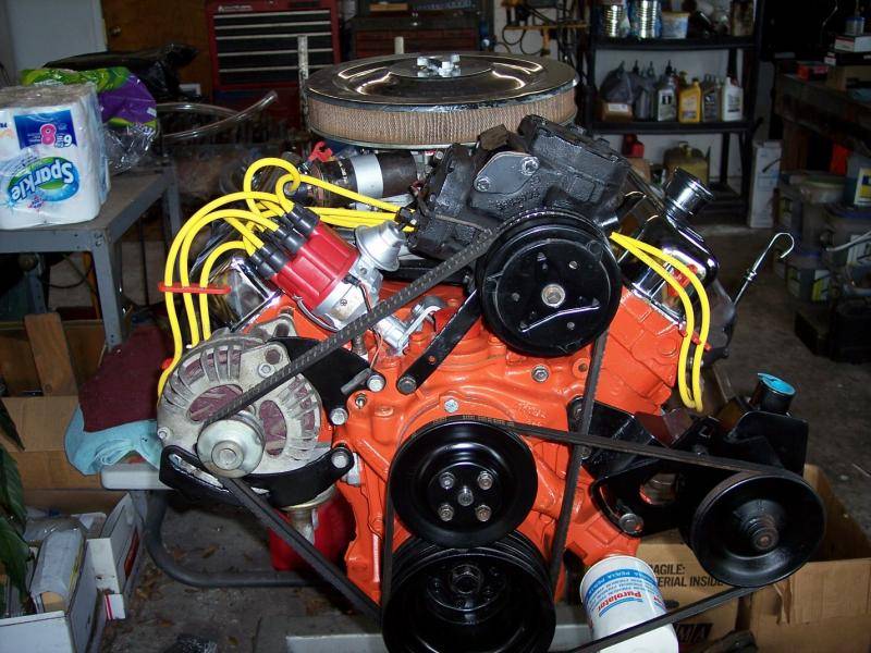

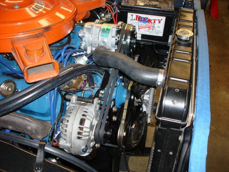

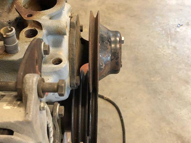

I didn't like the look of the 4 belt setup that the factory used with the A/C and P/S applications. To me it looks too cluttered and busy so I juggled a few things around to try to make a 3 groove crank pulley and 3 belt system work. I think that I have it figured out.
3 groove crank pulley uses 2 belts for the crank, alternator and A/C compressor. One belt uses the furthest forward crank pulley groove then around the water pump and power steering pump. I have mocked it up on a spare 440 but have not swapped it all over to my car yet. Alignment seems pretty close, I may need to shim to get it all just right.

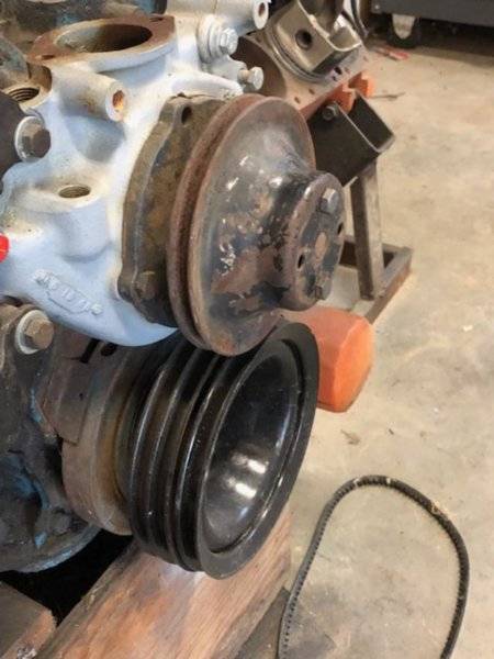

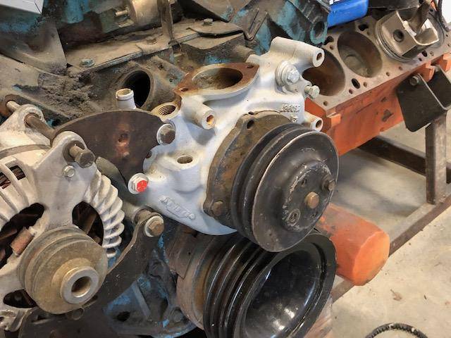

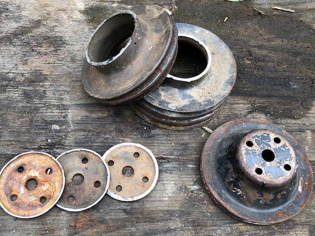

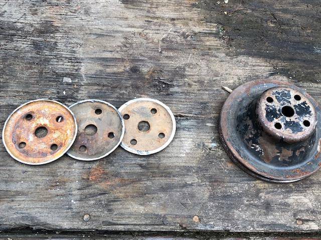

I have a bunch of 4 groove crank pulleys for A/C and P/S, a couple of A/C WP pulleys, a few Idler brackets and pulleys too. PM me and I might be able to put together a package for you for a fair price!
