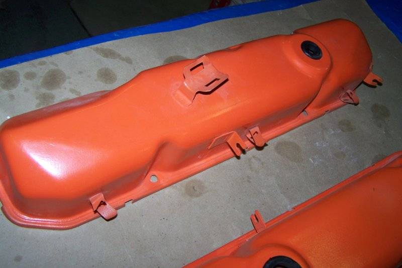

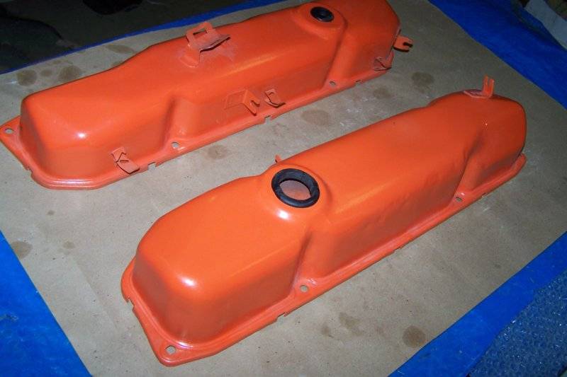

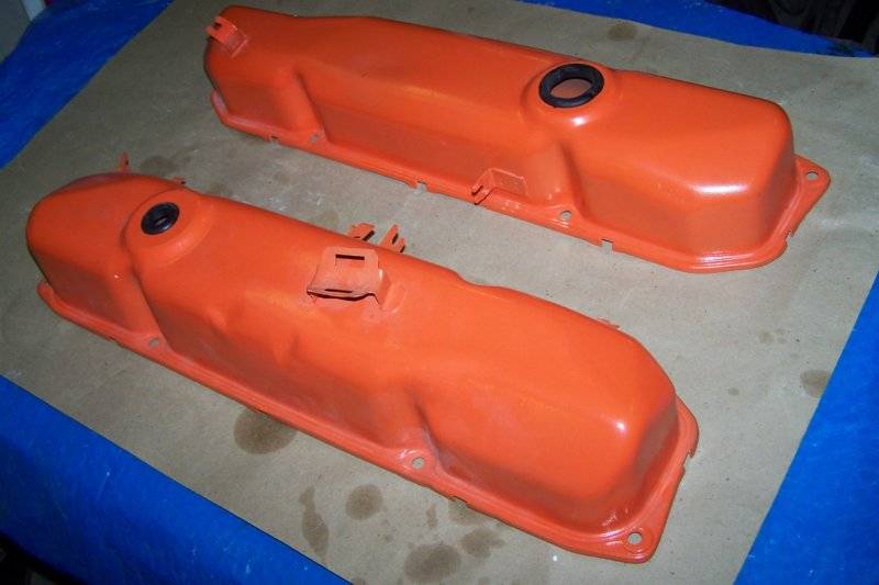

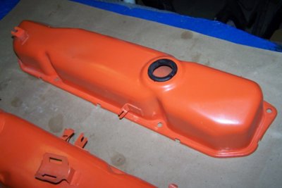

I have a set of valve covers I want to sell. I think they are 68 HP but not sure. Can anyone tell me for sure? Thanks
They're not '69.. as they have the heater hose bracket on the passenger cover.. so I'd suspect '68 is correct!
One with bracket looks like a 68 HP.
Other one-WT Heck? 69 and older should have the pipe for the oil breather to push over. Looks like the pipe has been removed. It has the raised circle. What does it have that large grommet for?
I should have caught that on the oil breather tube. These have to be mismatched valve covers. I have some extras, so I will probably find a 68 with the breather tube. Thanks .
