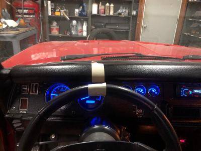

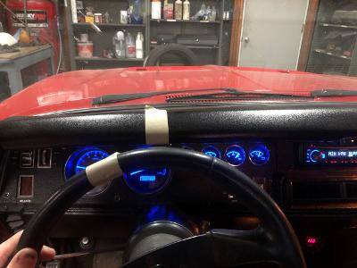

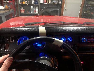

Going down the road, you're able to saw back and forth from the 11:00 position to the 1:00 position and the car stays going straight ahead.

If you don't have this free play in yours, that is really fortunate. My Firm Feel Stage 3 had 14,000 miles on it for these pictures and had been adjusted a few times to get as much of the slop out as possible. I have 3 other power steering cars here that have similar slop. My '75 Power Wagon has a Saginaw steering box as did other trucks of this era . The response is almost instant even on an original 47 year old truck! The whole reason that I swapped to the Borgeson in my Charger was because I love to drive curvy roads as well and crossing over through that slop was really annoying.

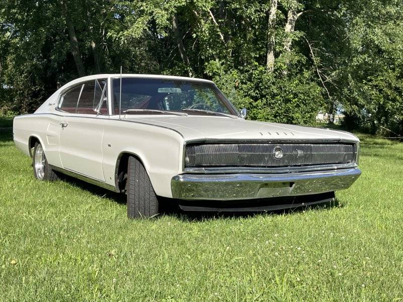

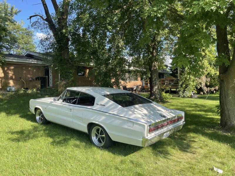

Nice gen 1 Calif. Charger, I like the build style too
cool Calif. Coronet waiting in the wings too :thumbsup: :thumbsup:

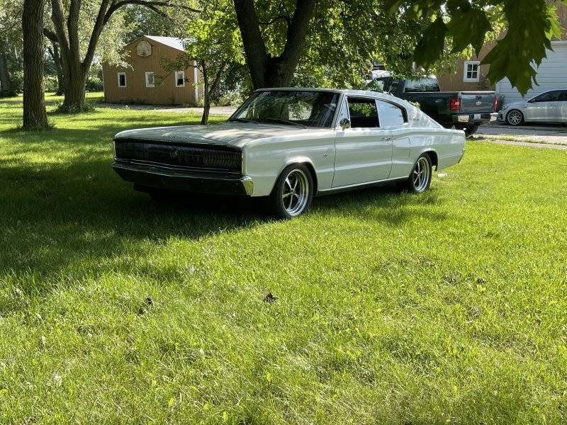

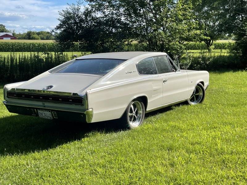

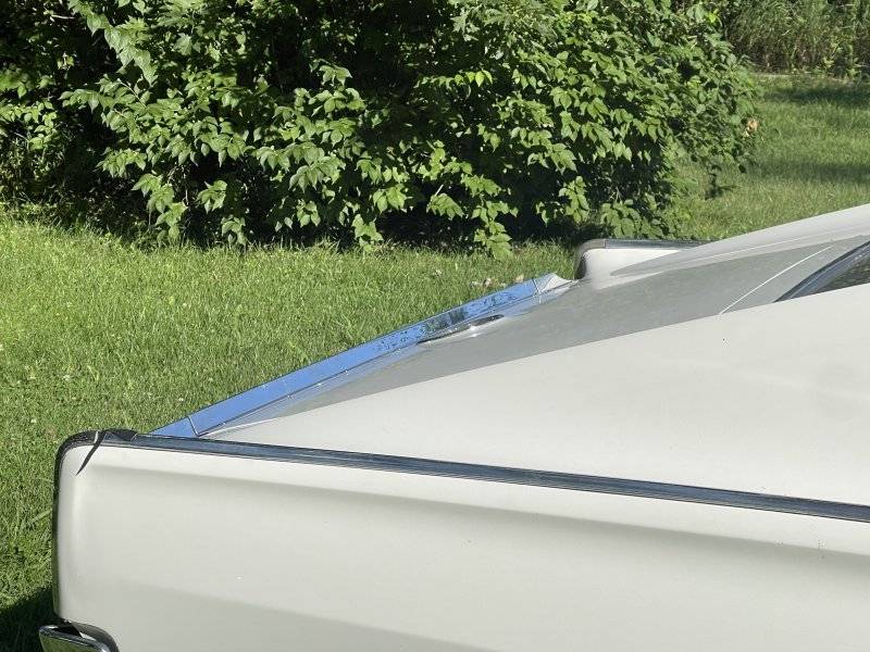

Added some much needed aero today. The addition of the front and rear spoilers combined with the Hotchkis suspension and Firm Feel steering make the ole girl feel planted at 115 MPH. It’s honestly a night and day difference. The Dr Diff stage 3 brakes are confidence inspiring as well
The wings look great! They do their job, without taking away from the beautiful body lines.

That's excellent, love the look!
