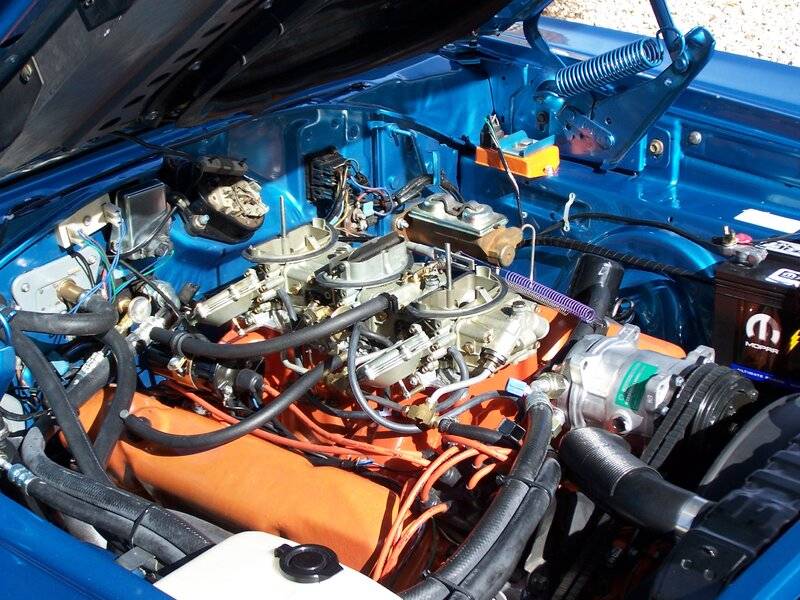

Hey FBBO, my low compression 440 has served me well for 22 years, but I'm ready to step it up a bit. Its a 73' cast piston/crank engine I pulled from Pick N Pull and refreshed with rings and bearings years ago. I did install 906's with 2.14/1.81 valves that had the ports cleaned up. I added a "6-pack" cam that was in the .450" lift range and used the stock valve train. It has a 6 pack setup and HP manifolds. Its a decent driver, runs 87 octane, and stays cool with the A/C on during hot summer days. It's a decent setup that runs low to mid 14's in my 69' Super Bee with the 3.23's and a 2500 stall converter.
So I've got some cash saved up and a 4.15" MP Forged crank sitting on the shelf, and I'm ready to build a stroker. I'm looking for big torque with stock manifolds, but still want it to be stock appearing. I've searched and read a bunch of builds and combinations here, and I just can't seem to find the right combo with the parts I want to use. I'm planning new rods/piston, bearings, cam, etc, but I want to reuse the following

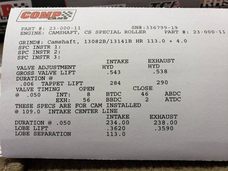

Well I have no real info yet but in a similar situation as you. I have a heavy 69 Fury III at 4200 lbs and did not want a rumpity drag car wannabe. Dwayne Porter designed a 440 [505] stroker for me. I told him I wanted to use HP exhaust manifolds and have enough vacuum for brakes. So he went through a new set of Stealth heads for me as when painted look stock and I went with a 440 Source 512 kit. 9.7 CR and a Porter designed hydraulic roller cam to work with the exhaust manifolds. I stuck with the 9.7 CR at Mr Porters recommendation so I can run pump premium hopefully even on the hottest days. I had a 11 inch torque converter made for my combination with 3.23 rear. I believe for the street and a heavy car as mine lower rpm up torque rules over high end HP. It will be completely painted Turquoise and look stock. Engine is complete but not in the car as of yet. Looking forward to what you come up with!
Can you post the specs of your cam?
Here is my card. I am using Howards hydraulic roller lifters.
