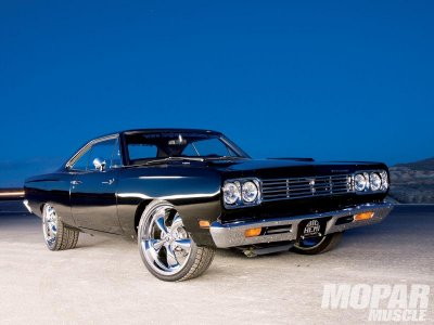

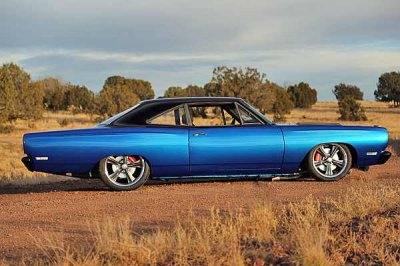

RDR-pass-1-tweaka.jpghmm
Your car and you do as you wish. I'm a old school person that likes both 100% stock and also modified cars. When I think "bigger" wheels, I think bigger wide. :) Not my car but love this look.

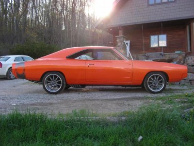

I really don't understand why people feel the need to voice an opinion about someone's taste in wheels when all they are asking is about fitment not whether or not you like it. I'm not a fan of the factor 14s and 15s either but I keep it to myself because it's just a preference. Having said that my 69 Charger has 19"X10s with zero offset (5" backspacing) and 18"X8"s also with zero offset (4" backspacing), they fit perfectly but the RRs might be different? As far as ride quality goes just ask Kahn about my cars ride, I replaced all of the suspension with stiffer bars, springs, poly bushings, etc and it drives absolutely wonderful (rides better than any car I've ever had).
P.S. I really don't think the wheels in your pic are 18"s and 17"s, look more like 18"s and 20"s?
Wow that is one bad looking RR, love the fatties!
Its just a pic I found online. Those are 20/18's. I have the hotchkis tvs system coming to help with the suspension. That's a nice charger btw.

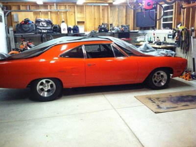

This is my ride

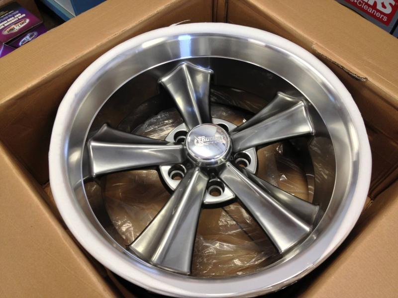

Well I want to go with these and hope the backspacing is correct. Im gonna stick with 17's all around.
17x7, 5x4 1/2 bolt pattern, 4.25" backspace- front
17x8, 5x4 1/2 bolt pattern, 4.50" backspace-rear
