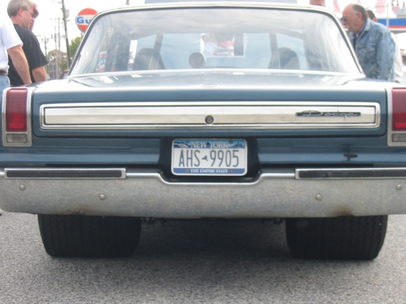

RJB you have a 295/50/15 with a 15 x 8 with 4 1/2 BS. It is stock spring location with no wheel well mods. what size wheel and tire are on the front. I definetly don't want a skinny but not something to wide either.
I prefer the big tire look.:munky2:
i was wondering the same thing..
I have a 15x8, 295/50/15, stock spring location and 4.5 backspacing, my fronts are 14in rims and tires, i use those just to move it around i dont know the size of those, and i have no mods to the fender wells. hope this helps.

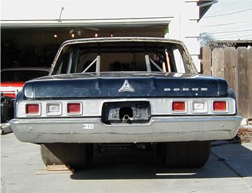

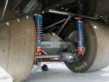

I like the bigger tire too. I just sold my big tire car and I do not want to cut this one up.
