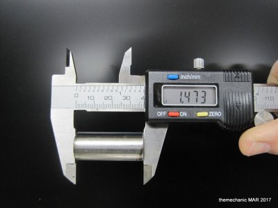

The shocks came with installation kit B4-KT1-Z236A00 containing two short spacers 1.291 x .505 and one longer spacer in its own bag 1.473 x .557.
However, the spacers are all too short; the longer one by about 5/32”. In addition, the longer spacer inside diameter is too large by about 1/16” making for quite a bit of slop with the bolt inserted.
So, I have to purchase two new spacers.
The black shock is the Bilstein and the silver one is the KYB I am replacing. (Incidently, I had no problem with the KYB front bushings or rear spacers.)
Rear shock spacers.JPG Rear shock spacers-001.JPG Rear shock spacers-002.JPG Rear shock spacers-003.JPG Rear shock spacers-004.JPG Rear shock spacers-005.JPG Rear shock spacers-006.JPG Rear shock spacers-007.JPG
