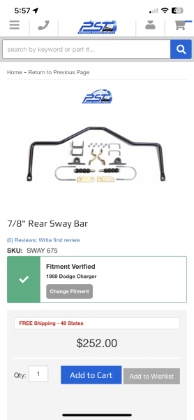

Can I ask the manufacturer and part number of the rear sway bar?

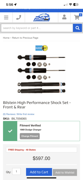

Could you provide the Bilstein part numbers for the front and rears? I went on their site and when I enter my car (69 charger), there are no options for me.

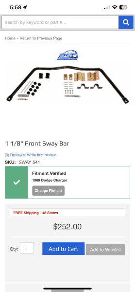

I had Monroe’s on my coronet, the Bilsteins blew them away. Rides like a new car. I will look up part numbers. The sway bar is made by PST. You can go on thier web sight. And see the one that fits your car.
Here is photos and part numbers . One stop shopping. PST sells the shocks as well. So there may be some sticker shock on the Bilsteins, but once you get past that. You won’t look back . That are amazing in these B Bodies. What I can’t tell you is which of the three made the biggest impact. I wish I would have installed one at a time, and then driven it. For me, I installed the front sway and the shocks first, and it just put a smile on my face. Then did the rear a couple weeks later. Added stability… I just got it aligned yesterday. Drives Sweet!!!!
