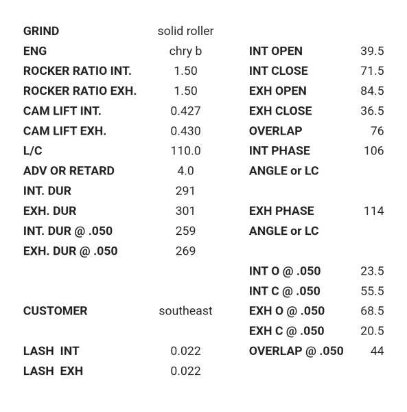

I figured I'd start a build thread on my Bill Mitchell aluminum RB (big bore 4.50") block, and I may throw in some chassis and traction aids stuff along the way, along with the Nitrous Express 6bbl N²O system if and when that time comes. I am having it gapped for up to a 350HP shot.
To kick it off, I'm posting my full cam specs that I needed some info from for B3E to get the T&D rocker arms tweaked for valvetrain geometry correction on the up to .700 lift TrickFlow 270 heads.
Here it is, comments welcome.

Please give me your thoughts on the cam specs. It's your haunting admonition against hydraulic rollers that coerced me into solid rollers w/EDM.

Why only 1.5 rockers?
Doug
My builder must have a reason.
I'm getting the rockers from Michael Beachel at B3E, his "tweaked" T&D #8260 and I just forwarded the cam specs he needed (lobe lift and hot lash) so I could ask him. I guess .640/.645 with the TF270s made for .700 lift was a good combo? Remember, I'm starting with and hoping to stay with my Promax modded 6bbl Holley carbs, in deference to the "V" in my VIN# and I love a 6bbl. Honestly, although I am pretty sure my "step up" would be a high flow 3x2 TB/DPI setup from Bruce at F&B, the only other thing I'd think of is a 6bbl "Dominator" setup or 2x4bbls. I like multiple carbs!
The reason why I went 572 vs 541 is neither require clearancing and I would have used an external oil pickup either way, and the Molnar crank costs the same, and I figure extra cubes can't hurt big, fat torque goals.
I guess 1.5 rockers to keep the springs that come on those heads away from coil bind, I thought 1.6's were the order of the day tbh which would be .680-ish lift with the B3 stuff, I think you lose a bit of lift with those?, that would probably require different springs.
So .645-ish lift with a 4.5" bore should net you around 350cfm from TF's quoted no's which is around what we have@.625" lash adjusted with our. 572-13's and 1.55 Jesel's according to some calcs I did for cfm/hp/et etc.
All in all the 2 motors are very similar, I would think you have a bit more comp than us (10.5:1?) and a lot more carb so 700+hp/700+ftlbs should show on the dyno, both good street/strip motors. Talked to my mate at the last race meeting, he said he gave it some right foot on the street but won't do it again in a hurry, and thats with a tight street verter as well, perhaps with some DOT race tyres but not on pure street tyres!. You'll have to post the numbers up Bio.
From Michael:
"My rockers are different than the T&D 8260, and account for the relocated shaft, which the 8260 does not. I need the specs to determine the exact amount of relocation needed".
He knows what I'm using, so I have to believe it will all work together.
I WILL ask about rocker arms ratio since I'm getting them from B3E.
The cam specs came from my builder. If the rocker arms from B3E have a higher ratio, I'll ask how that affects lift and the "up to .700" lift" springs
