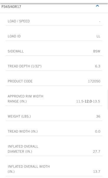

I'm likely to look for the widest drag radials (although I'm not ruling out bias ply 'street tires') with enough tread void in the pattern to keep me from being forced to park if I happen to get caught in the rain. My Toyo Proxes TQ drag radials have been OUTSTANDING in EVERY aspect of what is desired in a streetable drag radial, with the exception of a "shorter than desired for flex" sidewall. They look nice, but to have a shot at any kind of traction, they probably need more flex than they give.
I've been running these Toyo Proxes TQ 315/35/17 drag radials from the day I had the Year One aluminum Rallye wheels installed. 9" wide and 17" diameter wheel, with Toyo calling for an ideal wheel width of 11" and range of 10½-12½". The first thing I looked at was any sidewall bulge or concerns from my "cheating" with only a 9" width, but they look and run fine. I'm going to order the widest tire Toyo offers in that lineup, a the next size up from the ones I've been using, a 345/40/17 to see how they look on the same 9" wide rear wheel, and see if they fit in the wheelwell or leaf spring for clearance. 5" backspace is how the rear wheels come, and the ones I've had for at least 4 years clear everything with NEVER a rub.
BUT
If the 345/40/17 has no possibility of hooking on the street with the 572, but some kind of tire (preferably with decent tread void area) does have the ability to hook, on the street, my whole playbook gets rewritten and that means 4 new wheels and at least 2 new tires for street use.
For the track, I'm likely to see about a matching pair of rear wheels (but not a big deal-they are likely going to be 'track ONLY') with slicks, no compromise to traction, strictly business.
Any advice from those who know or have/are "there" I'm hoping for suggestions.
Look at this tread pattern and the specs, let me know if there's no real chance of these hooking:
What I have now:
I really like this look, if I have to go with something wider, and smaller diameter wheels are likely as well:
And I really like these too:
Or these (Weld Racing is the most likely source for 4 that look right together and have the dimensions that would work)
Here's the Toyo Proxes TQ drag radial, with the outstanding tread pattern that WORKS for safety on the outside chance of a puddle or rain:

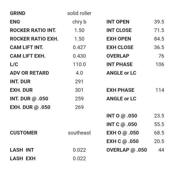

I figured I'd start a build thread on my Bill Mitchell aluminum RB (big bore 4.50") block, and I may throw in some chassis and traction aids stuff along the way, along with the Nitrous Express 6bbl N²O system if and when that time comes. I am having it gapped for up to a 350HP shot.
To kick it off, I'm posting my full cam specs that I needed some info from for B3E to get the T&D rocker arms tweaked for valvetrain geometry correction on the up to .700 lift TrickFlow 270 heads.
Here it is, comments welcome.
