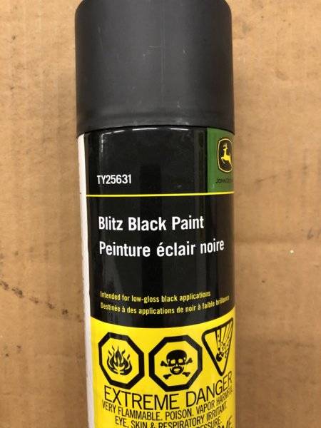

I use this paint, it’s between a semi-gloss and satin. Not 100 percent accurate, but as close as I’ve found. To detail lettering, I spray some into a Dixie cup and use a toothpick or a very small paintbrush to fill in the painted areas. Available at any John Deere dealer, probably online.
