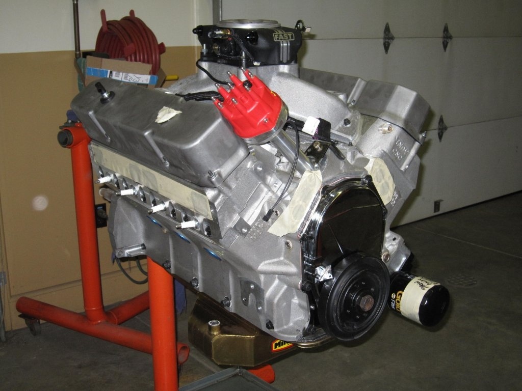

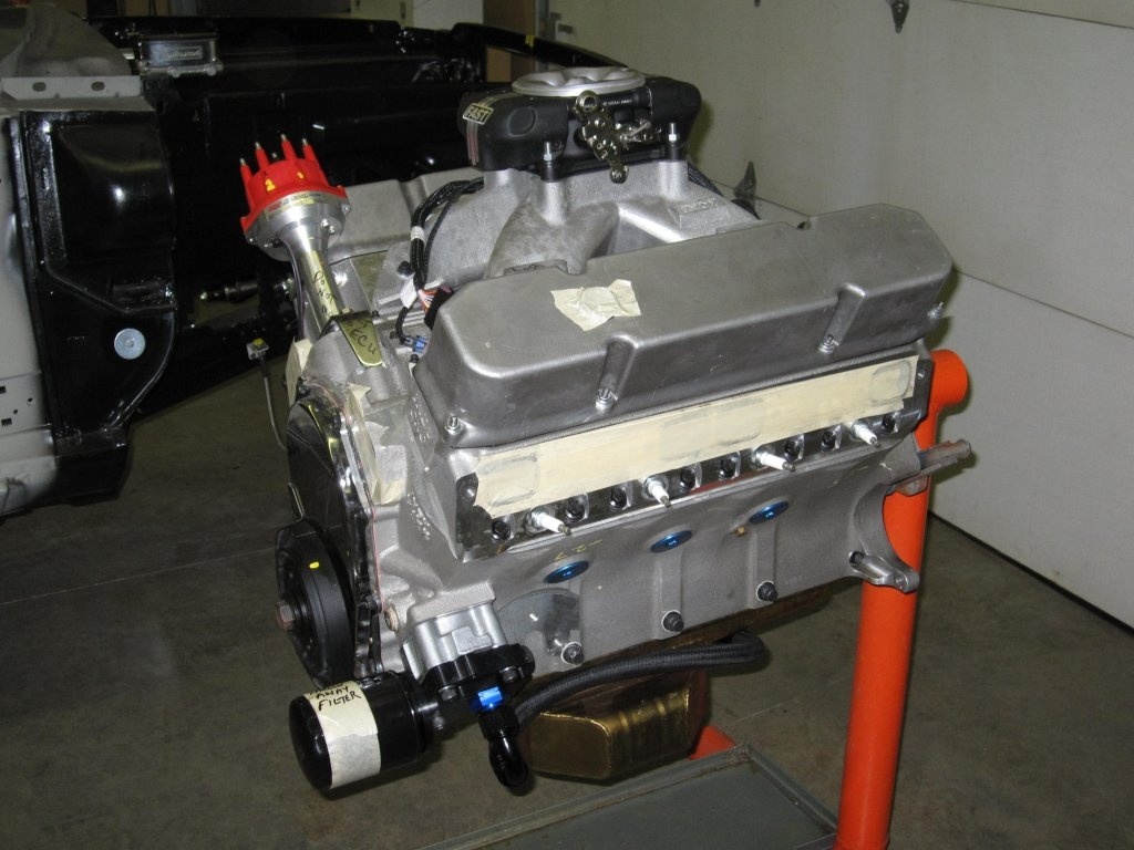

Hi fellas,
I bought a product named "Everbrite" to coat my aluminum engine with and it applied easily and did not change the appearance. No real world testing yet.
Mike

Thanks for that info! That product has a wide range of uses and I like the versatility. I am still hesitant using clears on bare steel, mainly due to having no luck with them in the past.
Any chance of getting pics of your engine you used this on?
Justin

Hi Justin,
Here are the engine photos you requested:
Mike
Mike
Thanks for taking the tine to post those pics. Man that looks great! I think I will have to try everbrite for some future projects!
Btw that is one beastly motor:thumbsup:
Thanks Justin,
I worked 7 years after retirement to earn "toy" money for this sort of extravagance! BTW, 765 HP.
