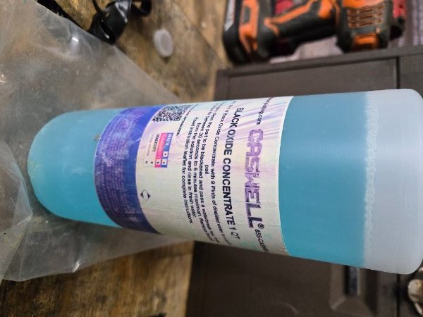

I use, and have used, several of the Caswell products over the last... decade or so, and I am quite pleased with their products. Once you learn a given plating process, and become acquainted with the chemicals and solutions used, you may find other cheaper sources for refills.
For a one-off, or for working on one car, a Caswell plating kit may seem pricey and/or overkill. But for repeat offenders, and working other cars, projects, clients, etc., they are among the best ways to get started plating if you live in the US, IMO.

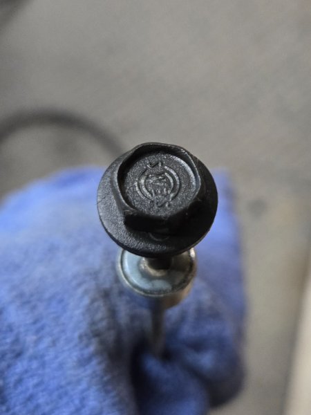

In for answers. Any that I had that weren't painted, are slowly getting the black oxide to protect from surface rust. Their stuff works great.

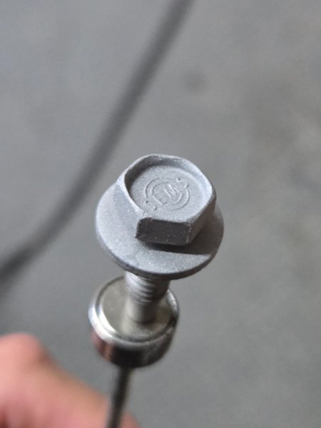

Those bolts were directly out of the blast cabinet, hosed off with Brakecleen.
