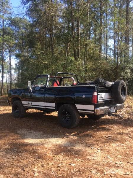

I used Tamco jet black single stage on my trail duster. It’s a blue violet mixture. Very black and glossy. It’s been in there 3 years and get driven almost daily and isn’t babied and it’s held up very well.
