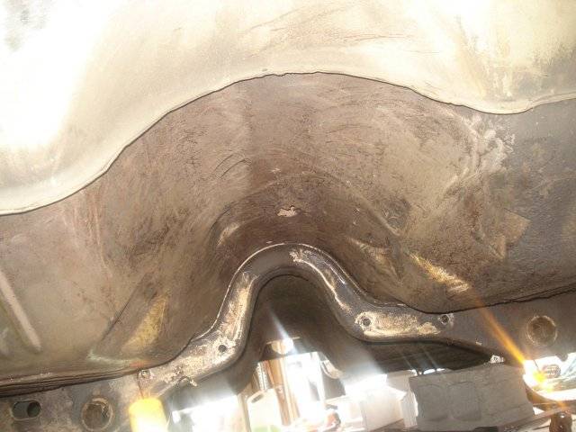

The undercarriage of my '73 Satellite is generally scaly and cruddy. Not rusty, just scaly and grungy looking (pics forthcoming). Was thinking about going to a bead blaster to see if they'd blast the underside. If they cover the car, will sand get into the interior? I'm not looking to strip the car for this. Anybody have this done?

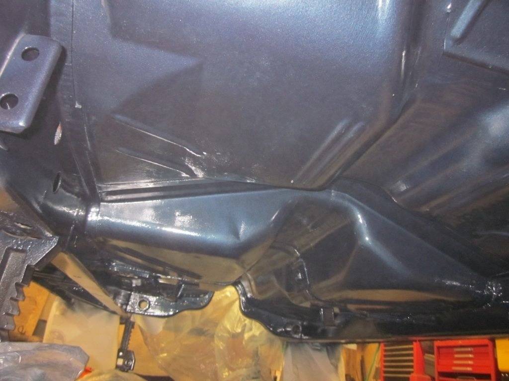

The guys that say sand goes every where aren't kidding! I blasted the underside of my car. No engine, trans, fenders and gas tank. Left carpet in and knock plugs out under carpet. Rolled car on it's side had a bad quarter. For months when you jacked car up piles of sand would come out of frame rails. We use the gas power compressor that I rented with the sand blaster to blow it out before we painted it. Couldn't get it all out. Looked great!

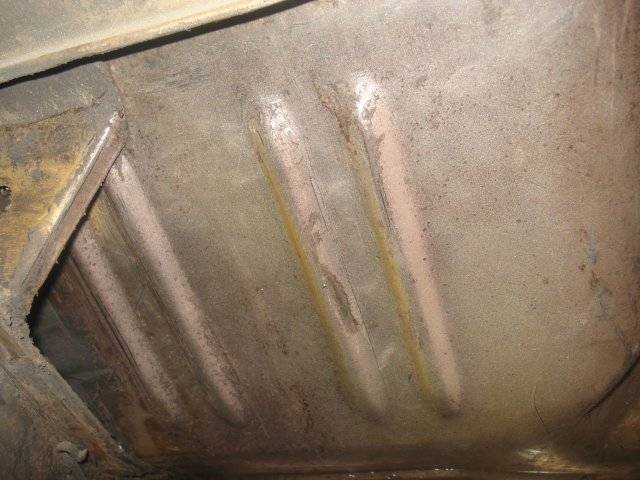

The whole floorpan basically looks like this, I was trying not to scratch it too much with the putty knife.
Oven cleaner and hot water pressure
I've said this in a few threads but paint stripper and a power washer does a wonderful job, gotta be careful and wear proper PPE but boy does it work.
