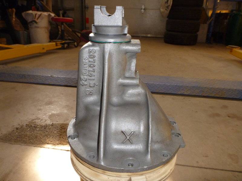

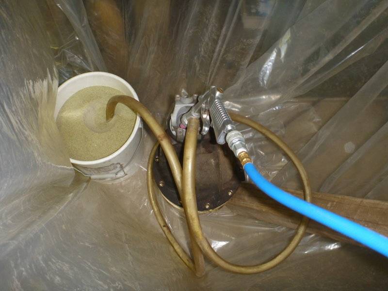

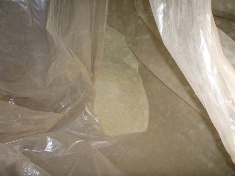

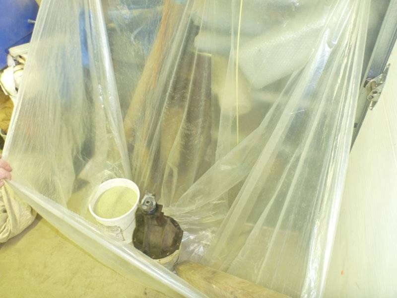

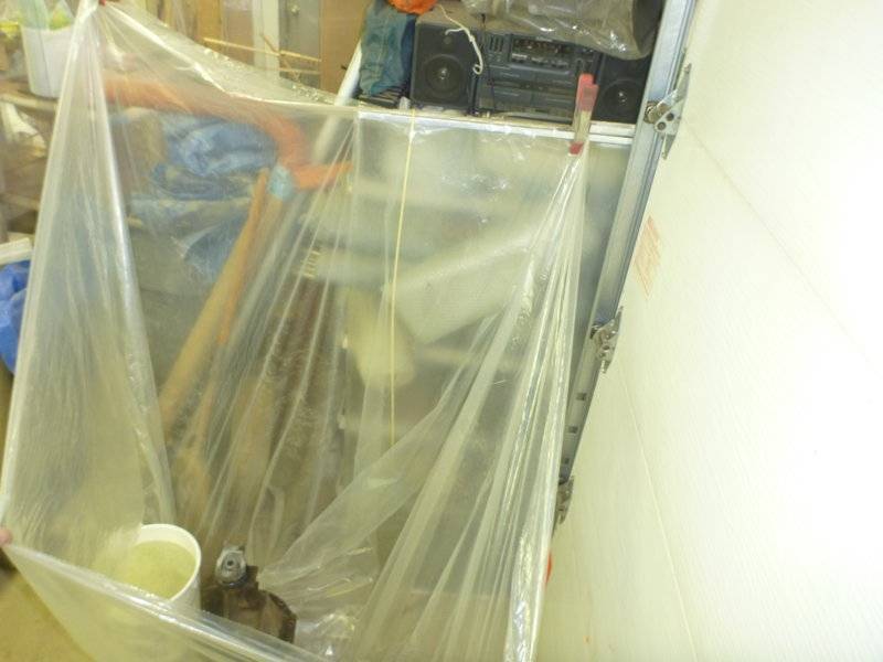

How did you keep the sand out?How I did my pumpkin as too heavy to put in the cabinet and need the pail to seal the glass out of the gear side. Shipping tub liner bag, but you could use a tarp with some folding.
View attachment 674472 View attachment 674473 View attachment 674474 View attachment 674475 View attachment 674476
